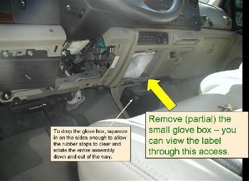

heres a video showing you where to look. It really is behind the access door. Youll have to move back 2 layers of insulation but its there up high and in the back

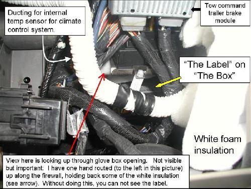

Re-posting pictures.
The links to the photos in my 2007 (!) post have not worked for a long time, and when they were up, several people found them useful. So I am re-posting them here.

I used a Ryobi scope to get to the code. It has a light on the end and it made it really easy to find the code way up under the dash.
