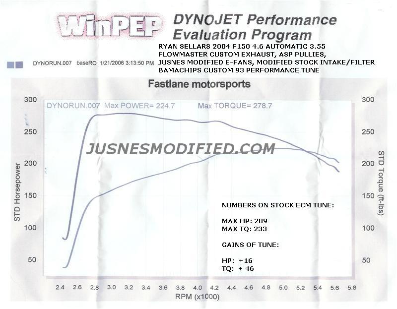

The torque of a tuned 4.6 compared to a stock 5.4 is shocklinly close. Our dyno posted earlier showed roughly 279 at the wheels on a tuned 4.6. A 5.4 with the SAME bolts ons, on the SAME dyno, pulled just after that truck showed roughly 283 at the wheels, without a tune. So achieving the same torque as a stock 5.4 can be done with a few mods, the tune seems to give the largest boost.

hmm. all the dyno charts i have are scanned pieces of paper, so i cant lay one torque curve over the other. I think i already posted our 4.6 chart up, here is a chart of our 5.4 without a tune. Right now im having a hard time rounding up the chart that was WITH a tune, but we were having trouble with the dyno. Its apparent in our 5.4 chart that we were having fun dealing with the torque management, which kind of skewed the torque curve, giving it that wavy look. The numbers arent actually too bad, this run was done with the stock intake and stock tuning. Only mods were pulleys, fans, and magnaflow cat back

That's a good comparison. It's pretty easy to see that the 4.6 peaks early then falls off, while the 5.4 seems to peak and hold steady (other than whatever games the computer was playing). I guess the 4.6L is running out of breath up top?
Those 3vs and 2v 4.6Ls are nice! I'm use to seeing torque that looks like horsepower curve, not something that peaks off idle and holds steady.

Right, the 5.4 is pretty good about holding that torque, if we could have gotten the dyno to work like we wanted (we had a lot of trouble with the charts on a 6.0 PSD as well) we could have gotten some really accurate results, so i do apologize for that.

on a reg cab 4.6, with our efans, pullies, and a custom exhaust, we dynoed 209/233 peak. We had BamaChips make a custom tune for it right there on the dyno, and peaked 225/279, so, at the peak of each band, the tune gained 16/46 at the wheels. I wish had gone back to look at the max gain. It held well above 250 torque until about 4700 rpm.
These engines have plenty of oomph that can be released, so dont fell bad that you got one, they still make enough power to move around in traffic.
