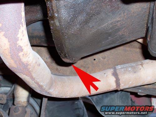

It seems like this leak is between the oil pan and the flywheel housing. I guess its the oil pan rear seal? Please take a look at the pics and let me know what you think?

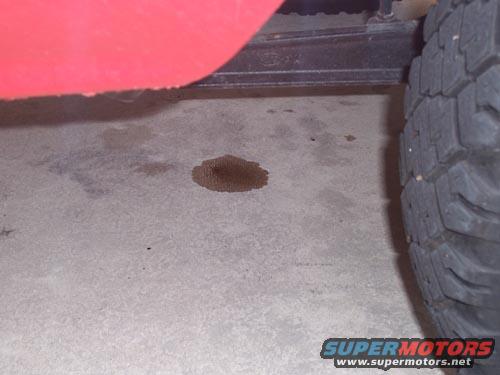

Flywhhee housing picl
[/img]
flywheel housing pic

About 90% if my leak was the oil pan plug gasket. It is a 9/16". Your leak looks familiar. I just keep a tray and cat litter in the garage for my big stud marking his territory.

That would be my guess too. GREAT pics btw...and a nice looking underside of your truck. You must live in the south!!

I'd fix it if I were you, the oil tends to get into places where you don't want it like the starter and wiring harnesses, and all over the Y pipe so that everyone thinks your burning oil. If its the pan, the gasket can be replaced without completly removing the pan as long as your comfortable working with your hands and not with your eyes.
