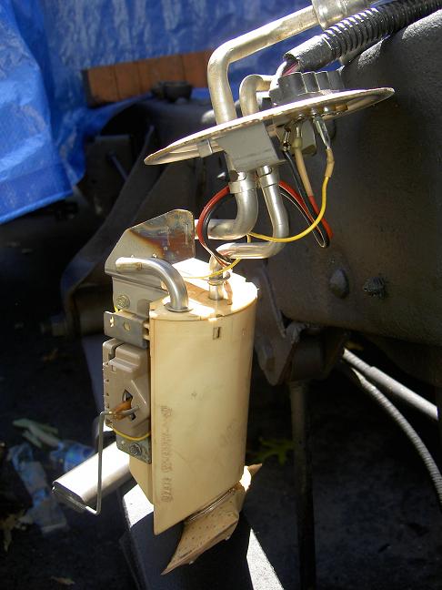

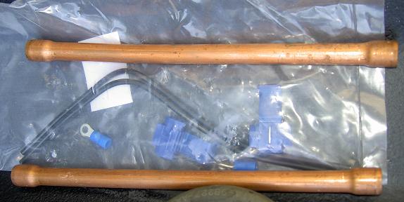

Help!
I am installing a LMC 38 gallon tank in my truck and don't know exactly what to do with the "extra" stuff. They sent along a couple copper tubes and wires. I guess I could make a crack pipe?
I called LMC and they were no help, so I am turning to you guys; the real experts.
I am guessing that they are to drop the pump farther into the tank but don't know how or where to put them.

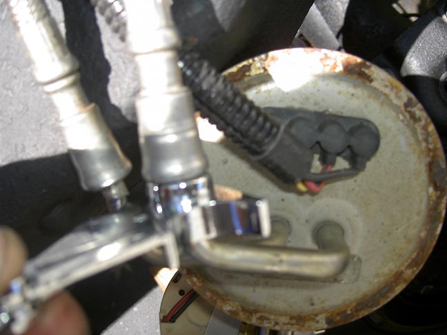

I also cannot get the fuel lines off using the ford A/C fuel line disconnect tool. I think I have one that is too big?
My wife is tired of seeing the truck in the driveway on jack stands, and I sure would like to drive it! HELP!
Old Aug 17, 2006 | 12:12 PM
beartracks's Avatar
beartracks
Joined: Nov 2000
Posts: 6,625
Likes: 342
From: Albuquerque
That stuff is to extend the pickup and the gauge wire. You need it to get the sock on the bottom of the tank or you want be able to use half the gas. You would cut both tubes and silver solder in the extentions.

Riglertke - right.... the pipes extend the supply / pickup lines and the wires extend the gauge wires farther into the tank.
Mine had the instructions with it - evidently yours got lost.
You'll have to braze the copper tubes to what you cut. I used a hacksaw on the back porch to cut mine - 2 beers and it was all done.

I cut the lines but it seems like they are aluminum? Does anyone make a pump for this replacement tank? I would feel better with one done professionally than with tube soldered in and the wires spliced.

After looking closer I realized that they are stainless steel. A friend and I are going to solder them tomorrow. I hope it works!
