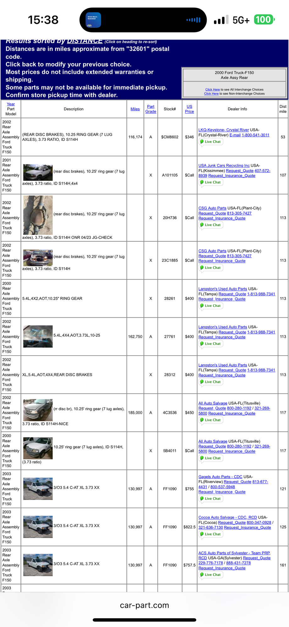

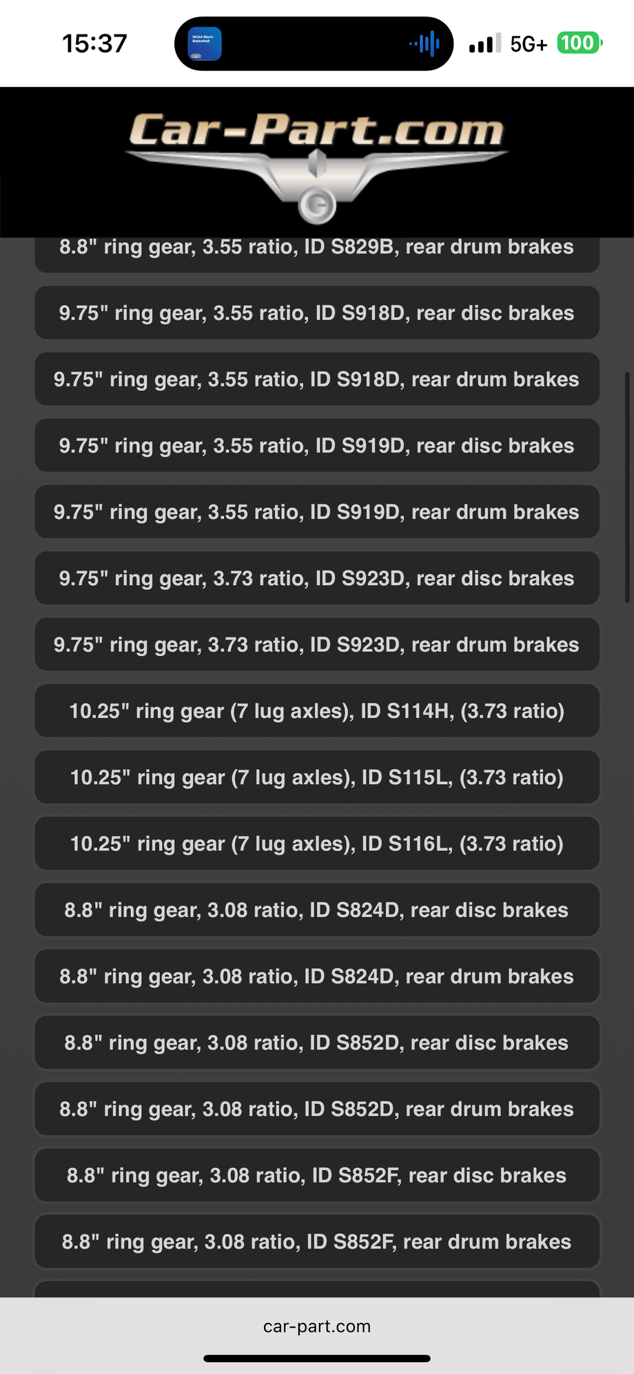

03 F-150 7700 with a 5.4 4X4 rear axle
My 03 needs a new or not bend Axle and I need help find out what type axle it has, I looked at the plate on it and the only number I can pick is a V115A, must web pages tell me it is a 3.73 ratio axel but they don't have and ID# V115A as a replacement. what can I replace it with. I like my truck and just had the engine rebuild so I don't want to let go of it. Help
Old Mar 22, 2026 | 03:39 PM
  #37
Johnny Paycheck's Avatar
Johnny Paycheck
Joined: Jul 2019
Posts: 1,280
Likes: 307
You have the Sterling 10.25” rear axle.
You’re only getting one that matches from another 10th Gen 7700 model.
https://www.car-part.com/cgi-bin/search.cgi
I just entered a random Florida zip code…
Old Mar 22, 2026 | 04:19 PM
  #38
Postal wingnut's Avatar
Postal wingnut
2nd Gear
Joined: Mar 2026
Posts: 2
Ok so that ID # dose not have to be the same got it Thank you
Your axle (if a series 7700 or LD 250) is a 35-spline and the rear gears are Sterling 10.25" . Never replaced the axle, but when it was out of the truck during a posi clutch pack replacement, I was astonished at just how big it was. Same as my Super Duty 6.0, but the Sterling 10.25" morphed into a 10.5" but still take the same gear sets and clutch packs.
I hope this helps....
