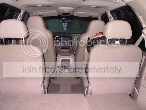

Man, that's great! Do you have pic of the driver's seat on a 98 showing the lumbar support cable?
Old Jun 22, 2006 | 08:42 AM
flipside's Avatar
flipside
Joined: Jun 2004
Posts: 3
From: Jacksonville, FL
I took the middle seat out of my wife's 04 expedition to make more room for a trip in January and kept it that way ever since. It's easier access to the 3rd row rather than having to lift up the seat to get to the back.
