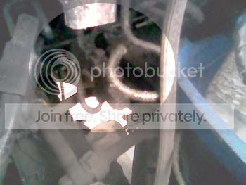

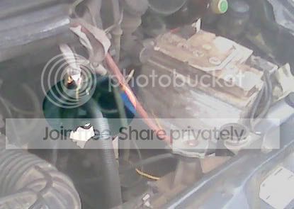

Old Jun 7, 2006 | 11:17 AM
Pablo-UA's Avatar
Pablo-UA
Posts: 5,242
From: Kiev, Ukraine
Look at this photo! There is a valve, but there are no wires! How to ajust it?
Old Jun 7, 2006 | 12:01 PM
ken1mod's Avatar
ken1mod
Joined: Aug 2005
Posts: 996
These valves are not adjustable. you must purchase, buy, kauf an adjustable valve and install between that valve and MC. Mine had wiring plug on outboard side of valve. My valve has two solenoid coils visible on the body of valve. Are you positive you have rabs?
ken
Old Jun 7, 2006 | 12:04 PM
Pablo-UA's Avatar
Pablo-UA
Posts: 5,242
From: Kiev, Ukraine
I dont know? What is the valve on this photo? There are no wires there! What is inside?
