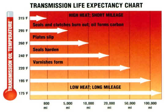

Engine should be 180 and trans 175 -180 no colder..They make trans thermostats if I remeber correctly. You can run it through the radiator if you have a loop

Are you monitoring the trans fluid temp? As mentioned above 180 is a good target temp, the fan may be overkill depending on the efficiency of the cooler.

Basically the trans should kept as cool as possible. Without extreme measures, 180*F is about right. Cooler than that also has drawbacks I'm told, but I've never seen a tranny fail because it was under-heated. The trick is to not "overcool" the engine in the process. The engine lives best at about 210*F. (I know this is debatable, I'm talking in general). In some applications this can be a real balancing act. The idea is to get as close as possible without going to extremes on either component. Both generate lots of heat that needs to be dissipated. The tranny prefers less heat, the motor prefers a little more.
