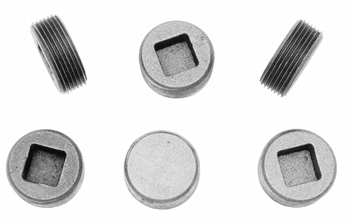

Well I've read about people tapping the freeze plug holes on these blocks for a threaded plug so you don't have to worry about them popping out on you. Most everything I read made it out to be a very time consuming tough process and a lot of the engine builders I talked to said it just isn't worth the hassle. They all recommended other means of securing a brass plug, including drilling tiny holes in the sides of the plug into the block and using allen head screws, epoxy, etc. I asked the maching shop working my block if they could do it and they looked at me like I was high on crack, saying it's a BIG hassle and they don't do it, blah blah blah. So I figured I'd give it a shot on my spare block because if I screwed up the block it was no big loss. I bought my 1.25" pipe tap off ebay for $10 and had at it tonight. The tap is HUGE so I didn't have a proper tap wrench to turn it with. I ended up using a 1 1/8" open wrench which I feared would lead me to drive the tap in crooked. Nope. Much to my surprise and delight the tap took EASILY into the cast block. I used a lot of oil and cranked away. I stopped with about 1/4" of the threads still out of the hole. I didn't want the tap to get into the cylinder walls so I was cautious with it. What I've often read about is people using 2 taps, one regular tap to start and then a second tap with the end cut off so they can go in deeper without touching cylinders. I'm going to wait until I can pick up plugs tomorrow to decide if I need to do this or not, but either way it's still easy. All 6 plugs took me less than 20 minutes to do.
So now that I have it figured out I'll definitely be doing this on the 557. I'll snap some pics tomorrow when it's light out and when I can test fit the plugs. Just wanted to share the info for anyone else interested in doing this.

Well not to say it could never happen but I haven't ever had a block freeze, even at -40º. A little antifreeze and all is good to go. I'm more worried about a plug spitting out while I'm standing on the throttle and loosing all my coolant. Besides the inconvenience of having to replace a plug and being stranded because I dumped coolant I have over $40 into water wetter I'd hate to lose.
I got a 1 1/4" plug today and it fit perfect. I was gonna snap a picture but it's dark again.

I posted this thread for informational purposes for those who are interested in doing this to their own blocks. I'm certainly not saying this is something everyone needs to or should do. If you don't understand why a person would need to do it then I'd venture a guess you're not running an engine that might require it so it's not really of concern to you in the first place. However, if you run a stock block with no hard block in the jackets at over 1100hp with brass plugs slathered with aviation goop and you've never had a problem then let me know because I'm all ears. These blocks torque under that kind of power. Threaded plugs add stiffness to the block in addition to keeping the plugs from blowing out (which is particularly a threat if you run a mechanical water pump and you're spinning 7,000rpm). Something else to consider is the fact that several drag racers have been put into the wall by the spew of coolant from a blown plug under their tires. A sudden gush of coolant at high speeds is not a good idea. And while I don't plan to race at the track frequently I DO take the truck on some long, remote drives and I'd hate to be suck in the mountains waist deep in mud because I lost a plug and dumped 12 gallons of coolant.
Btw, the aftermarket racing blocks such as IDT's blocks are being shipped with threaded freeze plugs. Do you think just maybe they might be onto something?? Same with those silly guys in Ford Racing . . . not only selling threaded blocks but plugs to go with them!

I was thinking of doing the same to a block I'm working on now. Does anyone have a source for the shallow 1.5" threaded plugs. I found 1.25" Plugs from ford for some of their racing parts, but didn't see 1.5".

Sandy, have you tried a plumbing shop or a hardware supplier store, like a Home Depot or Lowes?
