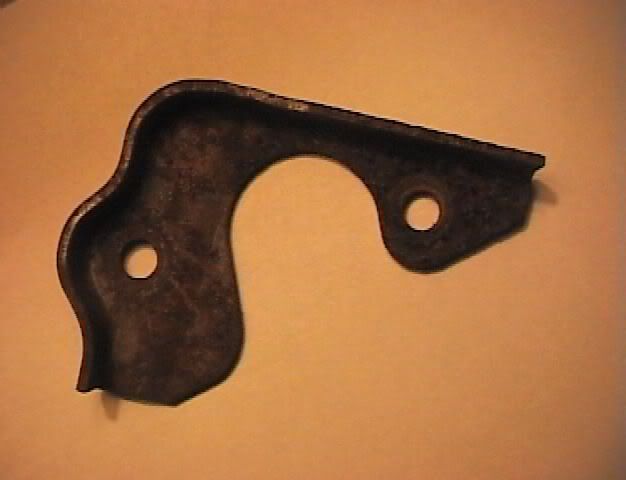

I finally bought the e8tz7k509A bracket. When I looked under the dash, I coundn't find where this would go. Does this go under the break pedal mount? On that there are four mounting bolts. This L bracket only has two holes. They do not align with these studs.
Or do I have a bracket for a different truck?

From inside the cab, pull the insulation back from around the two studs that hold the clutch master cylinder to the firewall. Remove the two nuts from the master cylinder mounting studs. Install the bracket then reinstall the to nuts.
The bracket will only fit on one way.
This picture shows the bracket. The flat side of the bracket faces the firewall.

Awesome!!! That picture is exactly what I have. I'll re-look at this.
