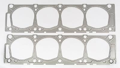

summit lists a head gasket by ford racing that is .040 with a 4.23 bore as opposed to the .041 and 4.4 bore of the fel-pros... if your opposed to the .020 steel shim route that may be a little better solution, its about a half a cc less if you wanna get down to the nitty gritty... :-)

milling the haeds will make it worse. A set of gaskets is cheaper and easier.

i don't think just reducing the combustion area is going to help with anything. Got to get back to the .040 quench area.

Here's the gaskets I've currently got in my 390:
Mr. Gasket .020" steel shim head gaskets. $20.69 from Summit, #MRG-1132. Spray coat 'em with Copper seal, torque 'em down, away you go. These and L2291 pistons, in my motor anyway, give .032" quench.

IIRC, this was a couple years ago when I had my heads CC'd, it was 74 before I polished them. Probably 76 by the time they went into the motor.

My 428 has the forged piston .005" down the bore, Victor head gaskets(stock replacement type) and has a measured 10.04:1 CR. I have VERY little pinging except under heavy pulls and low RPM. I think the quench is critical as Kurt has been preaching for some time!
