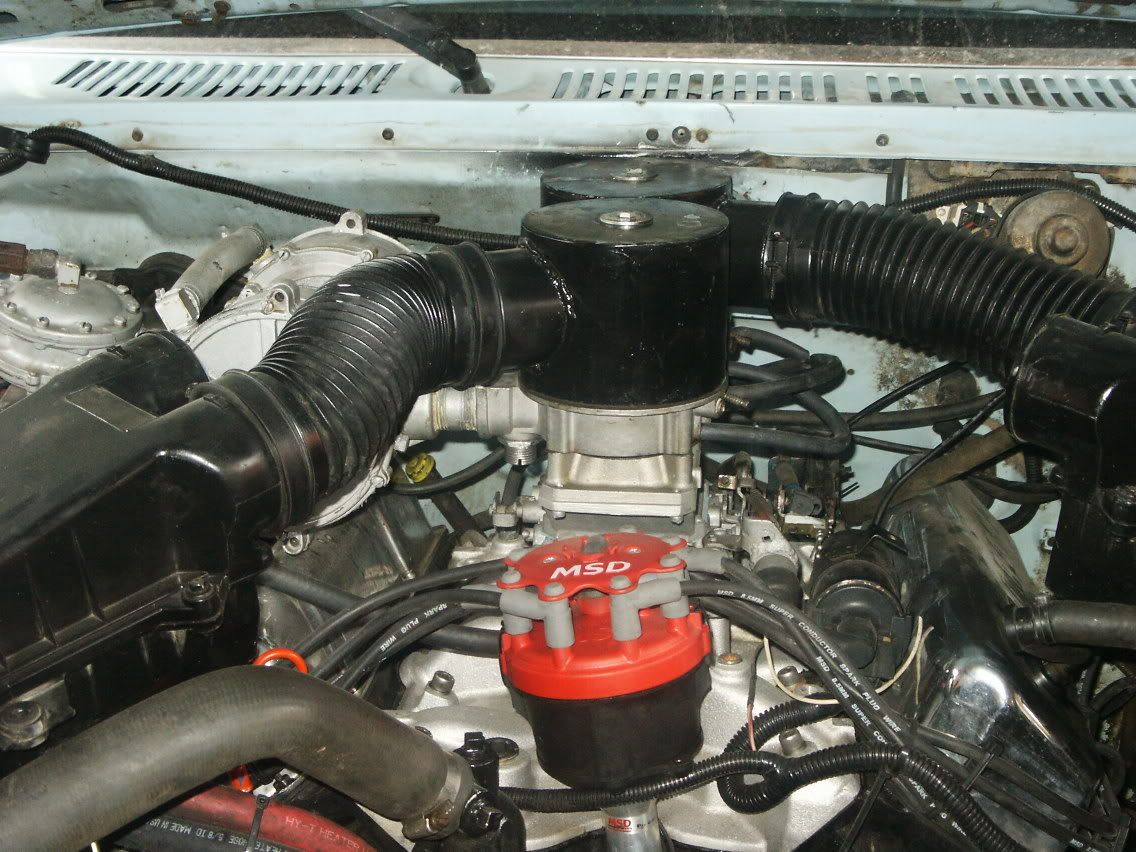

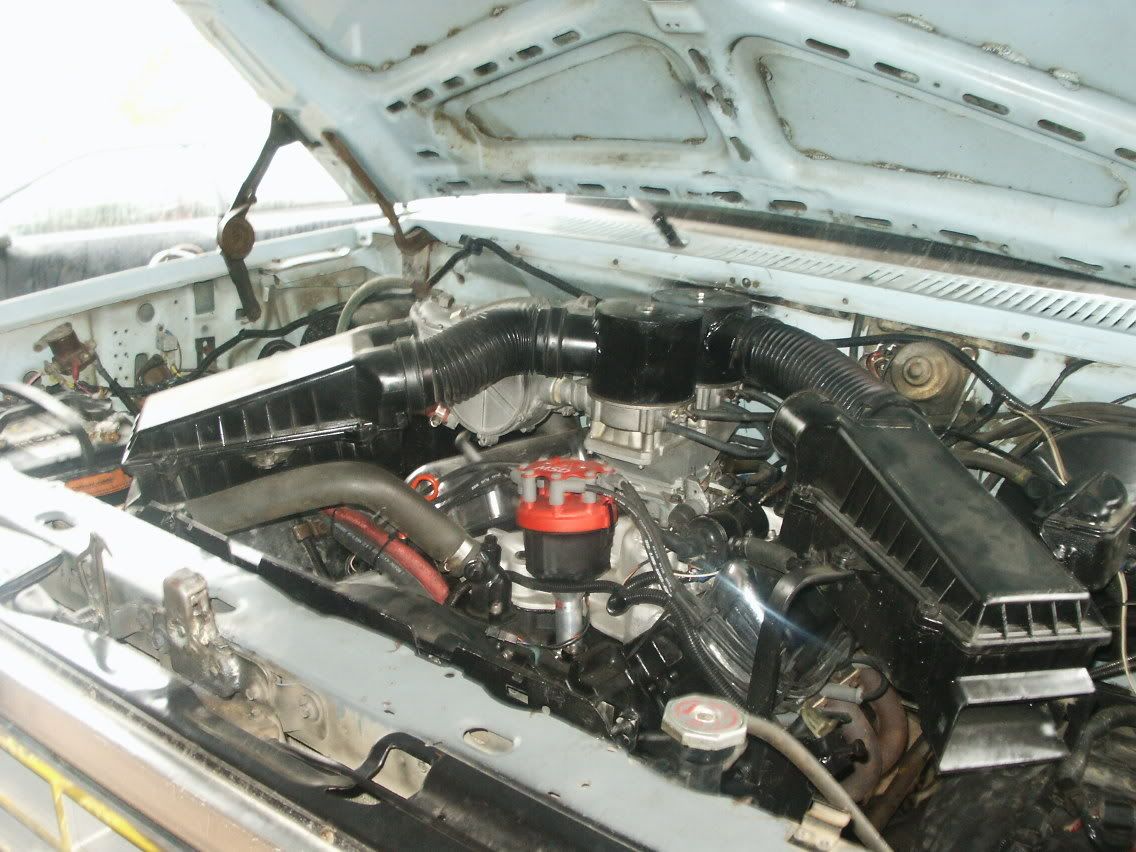

Hey Kionga.
Seems we have similar build spec wise. i too am running 11:1 but i used kb cleveland piston and i am running a roller cam with 2 ohg mixers on an adapter with a seperator between so the rear mixer works with the secondaries. you are correct that this is trial and error,not much info any where though i have found a few forums that have some good info. No dyno near me so i bought a gtech accelorometer, which is not too accurate due to so many variables, ie wind, vehicle drag, road resistance . It gave me 270 hp on the ground which i feel is conservative. The motor is in a 86 f150 which weighs 4800 lbs last time at the scale. I am running 3.89s with a 29 inch tire. Even with my camper on which i think weight at least 1200lbs i experience no pinging . Timing is 14 initial and 34 total at 2800. I feel that the money i spent on the msd distributor, 6al box and blaster coil was a good investment to get the propane lit.As for intakes , i have run both single and dual and am running a dual currently. i have found low end suffers on a heavy vehicle with the single plane. I was goin to go back to a single on this last build but my parents couldnt seem to locate my spare intake . My best 0-60 time is 6.9 secs which is pretty decent considering the weight. I included a few pics if you interested and i would like ot seee some or your car as well if you have any.For exhaust i am running duals with flowmaster 50 series which seemed to improve power but are damn loud, am lookin to add some resonators in the future.Future upgades i am contemplating are dual lines which is no biggy as i have 2 tanks. and a larger throttle plate , currently 750 mechanical secondary. I have a turbo from a 7.0L idi turbo thats been tempting me but that will have to wait a bit as i will have to lower the compression. cant hurt to dream lol.
Ne way is great to read about others having fun with propane, enjoy you build and i look forward to some pics.
