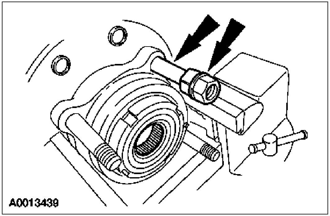

It's probably the needle bearing inside the "sealed" wheel-bearing (if memory serves) - I just checked my Ford service CD for 2001, and it shows a picture of the wheel-bearing/hub with a needle bearing inside of it for the axle to ride on.
The other guy I'm thinking of got lucky and it didn't trash the axle, but be warned in advance: You probably need a wheel-bearing, and the axle might be trashed too ...
Look at this:
http://fords.kilonet.org/krewat/ford-wheel-hub.jpg
art k.

I just walked in to see if there were any more replys. Thanks for the info and illustration.
It looks like there is a huge amount of play in the axle shaft inside the axle housing. Isn't there a bearing at the end of the axle just behind the seal behind the u-joint? Or does the needle bearing you mention provide the support for the end of the axle?
