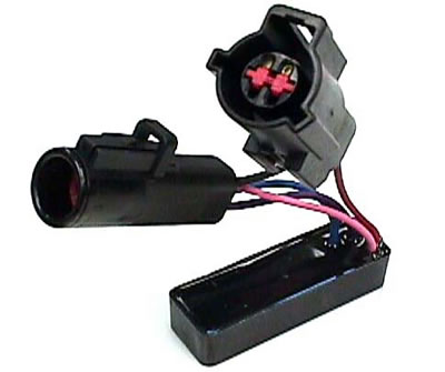

epncsu2006, this is the simulator i found on summit racing http://static.summitracing.com/globa...i-104040_w.jpg but i need to know if it just plugs in where my old 02 sensor was at or what, and i just read the post by rotor, and i am not trying to be an xxxxxx but i would like to know what kind of books he has been reading, he says all trucks only have one converter unles they have dual pipes, my truck came factory with single pipe and did have 2 cats, but now after some exaust modification it has dual pipes and 1 cat, its not true duals just 2 pipes after the cat out of a y, and now the 02 sensors on bank (manifold) are critical but the 02 downstream at the cat shouldn't matter, i believe it is basically just for emissions, well anyway how do i put this in, thanks, jimbob

I don't have any hands-on experience with a '96 truck, but I am pretty sure the simulator just plugs into the harness in place of the O2 sensor.

thanks alot for all the help, i think i understand how it goes, up plug the 02 put the sim in its place in the harness and just leave the 02 in the pipe.
