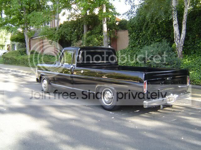

As far as the body; I live in NJ so salty roads and ocean air have left some wounds. Door corners, the radiator support, cab mounts, the lower fender corner at the door, and the usual Rotted and bent in the middle Tailgate. The bed is in Excelent condition. Though there is surface rust begining underneath the top edge of the quarter panels, basically the under rim of the bed. Also My truck has dual tanks like the one in the Pictures here
