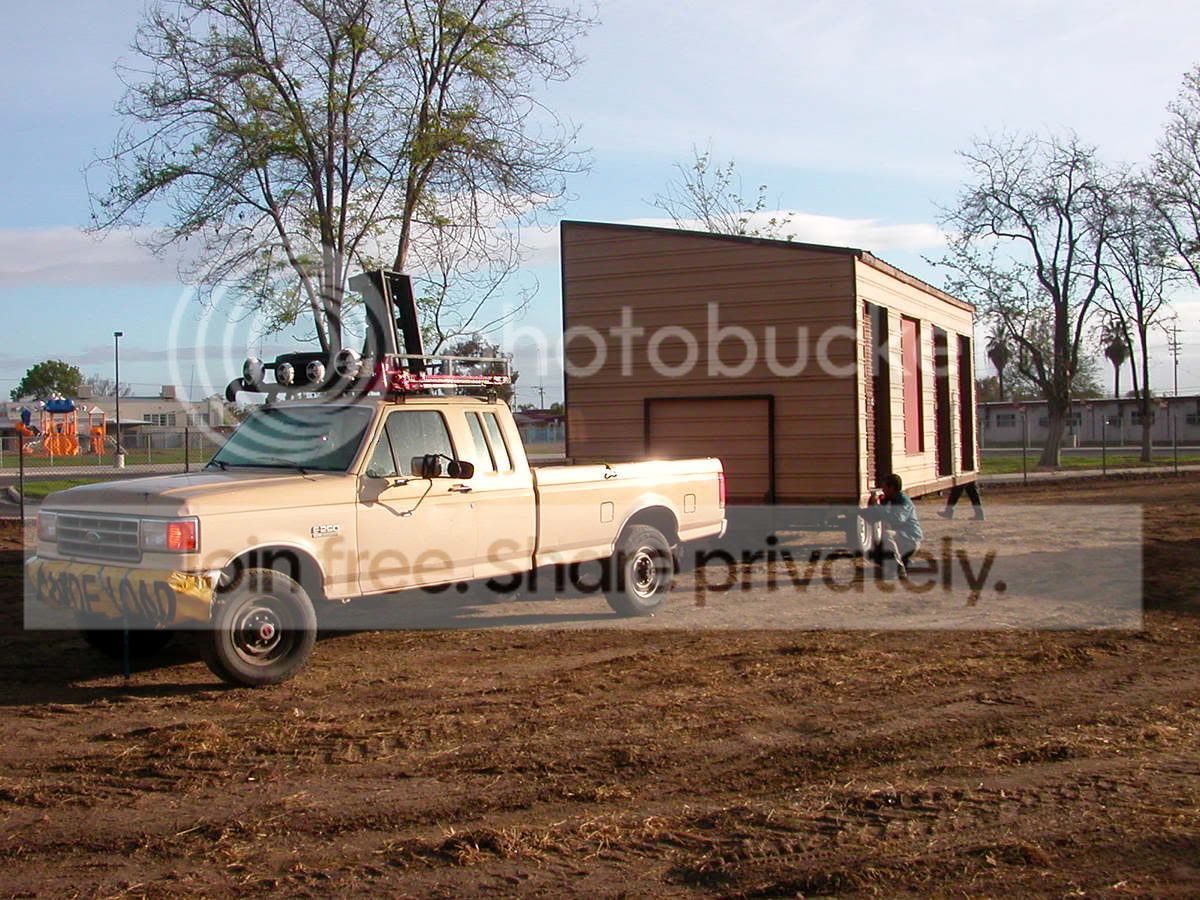

I had no problem at all hauling 26 of these over 100 miles apeice. round trip my truck did about 200 miles per building from LA area to Bakersfield:
