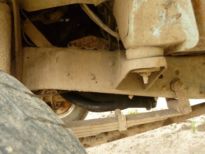

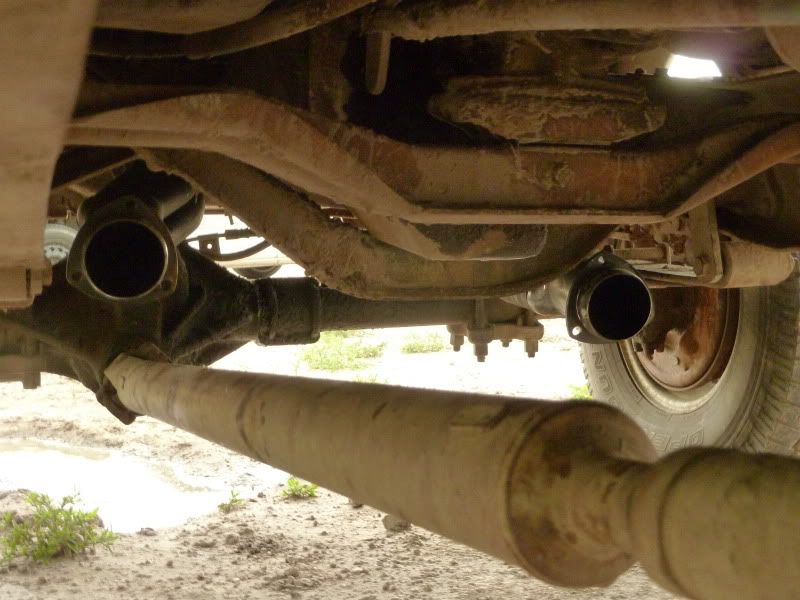

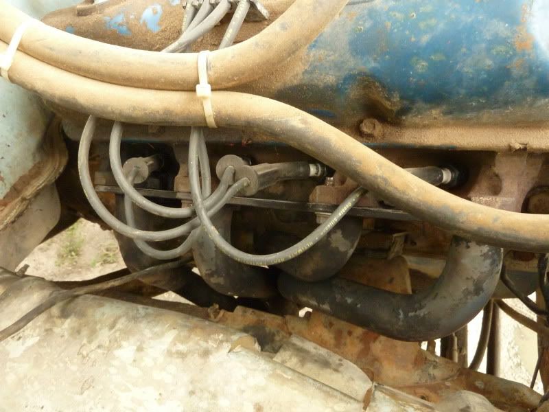

these are what i have on my 73, unbolting the engine mounts and lifting the engine made it alot easier, the only thing that i don't like is the one pipe that is almost touching the starter.
Excuse how dirty it is...

Yup, headers tend to crowd the starter. If I didn't have a manual transmission so I could roll it down a hill to start it I probably would have gone with shorties.
