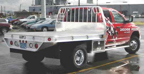

On Highway products web site under flat decks they have a DODGE RODEO truck that is showing the deck setup I like. My current Box is 7 long and they have a 7' x 7' version.

Nice looking bed.
Aluminum is also a good choice, it'll cut down on weight. It's 1/3 the weight of steel, but unfortunately about twice the price of steel also. If you go with a flatbed, pay extra attention to the fuel filler neck. Make sure it has some good drop down to the tank. If it is too level, the fuel will foam and slow down fueling. I had a F-350 with a custom flatbed which I had to park on a block of wood to get a decent slope when fueling.
