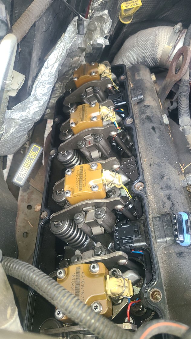

Ok, rechecked gpr, 12.6 in, starts at 10 9 when hit switch, climbs to 11.3, stays there approx 1 min ish according to stop watch and then stops, no power through anymore
checked hpop, yup, approx 1/2 in to oil.
​​​checked, heater has been removed and plugged before I got it.
checked fuel bowl, lifted out filter, 1/2 bowl when removed, spilled again when put back in....crap..
have pass valve cover off. Looks clean to me, very little oil inside, no noticeable wire issues. Bout to pull gp's and ohm...
was looking for pooling around injectors, how? never tried to start with cover off. is it gonna be messy?...what look for if top orings leaking?

Fuel filter is not black, Fuel is nice and green. ill get a new filter as it prolly needs it.
pulled the plugs from the injectors, connectors wet, oily , no gasket around them...issue? Wouldn't think so..but? Nothing frayed or broken.

Run with VC off, not messy unless you rev it up more than idel
UVCH will have oil on connectors. Dont worry
