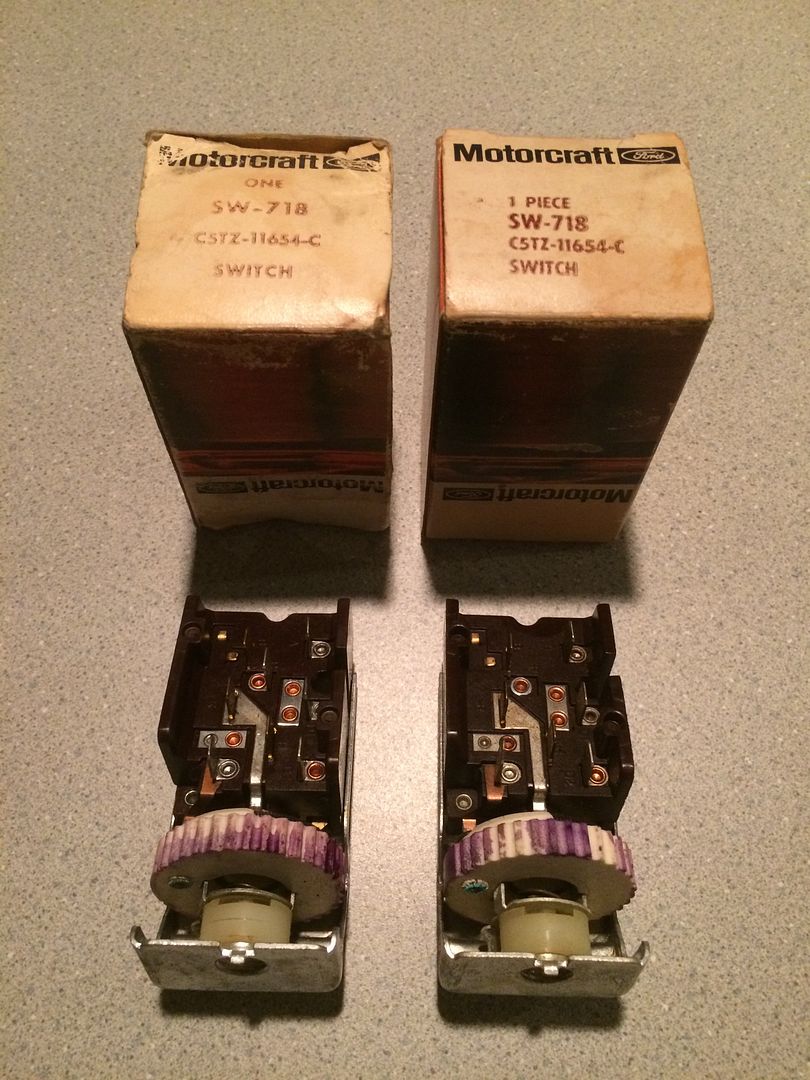

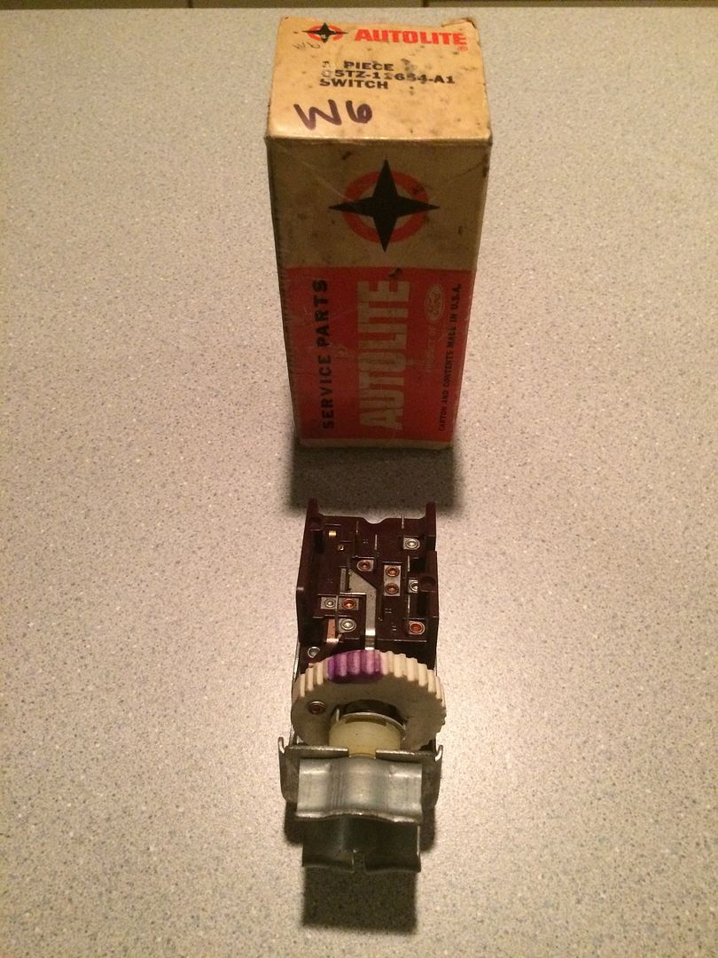

Ford offered two different switches for 1965/66 trucks B-C-F-N100/600
SWITCH ASSY. - HEAD LAMP - ON INSTRUMENT PANEL
C5TZ-11654-A (SW-439) - Ident. C5TB-11652-A - includes bracket & C5TZ-11654-C switch
C5TZ-11654-C (SW-718) - Ident. C5TB-11652-A
In other words, one includes the bracket and one doesn't, so you reuse your current bracket if needed. I tend to sway toward NOS but no guarantees they work perfectly after all these years.
Plenty of replacements on eBay that show some come without the bracket, some with it but loose and some with the bracket attached.
C5tz-11654-C for sale | eBay
