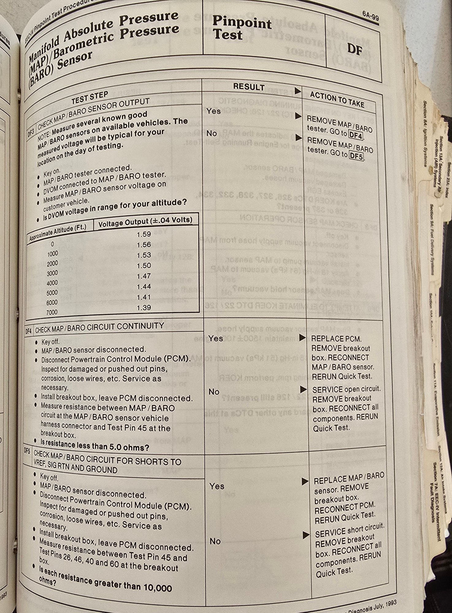

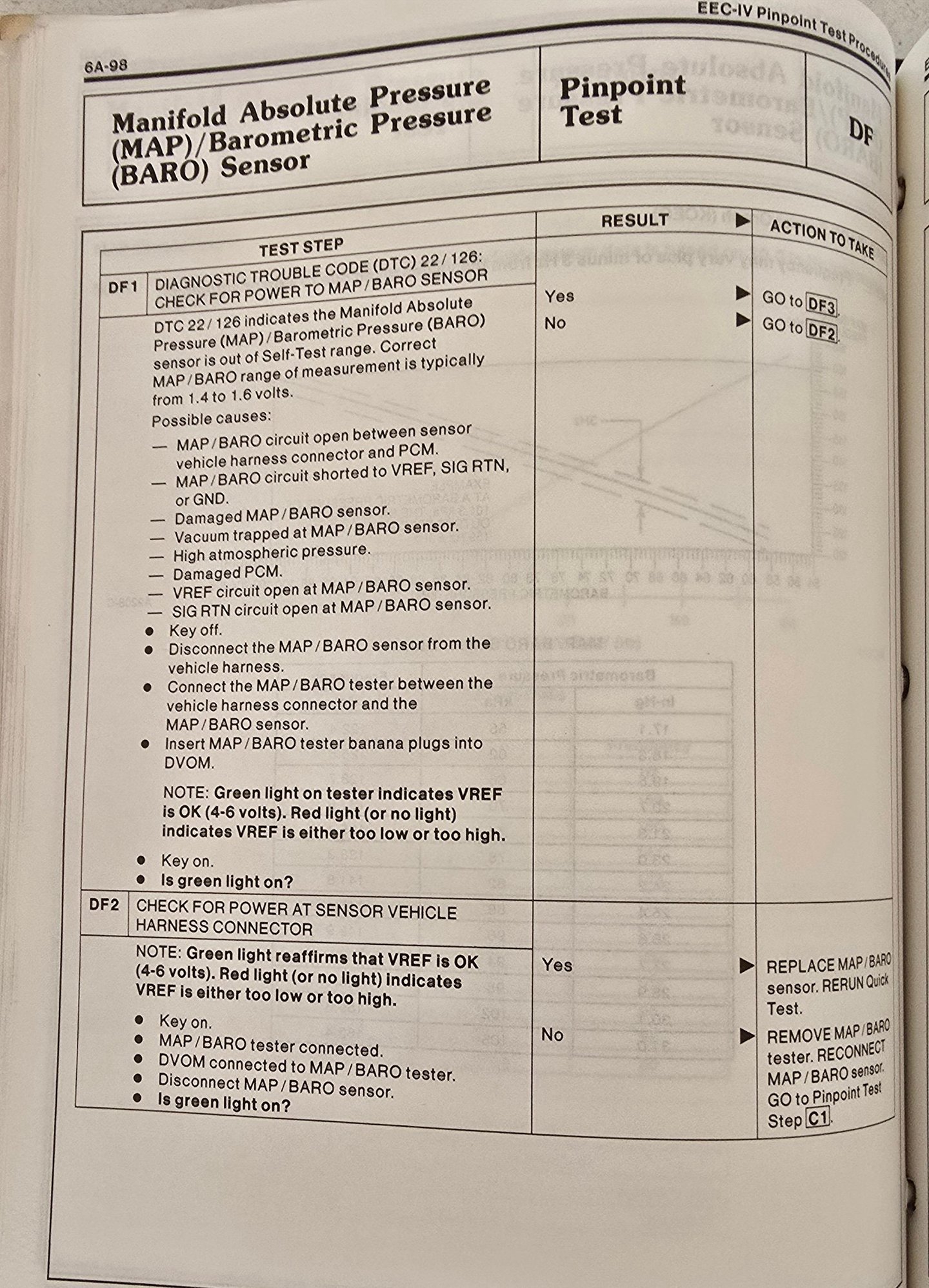

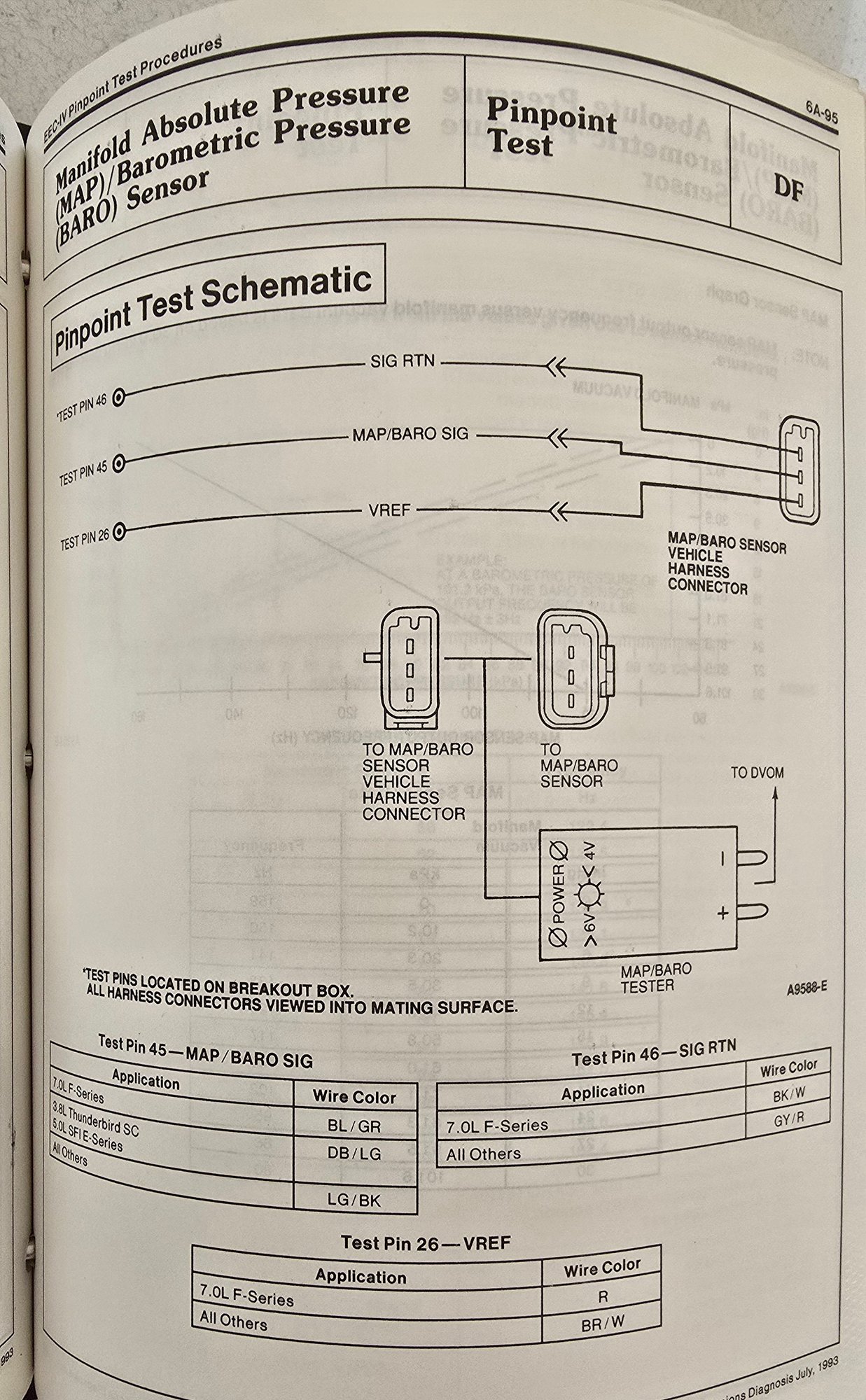

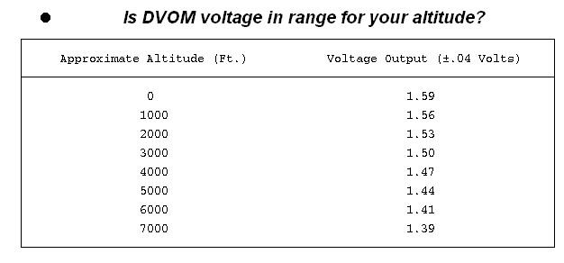

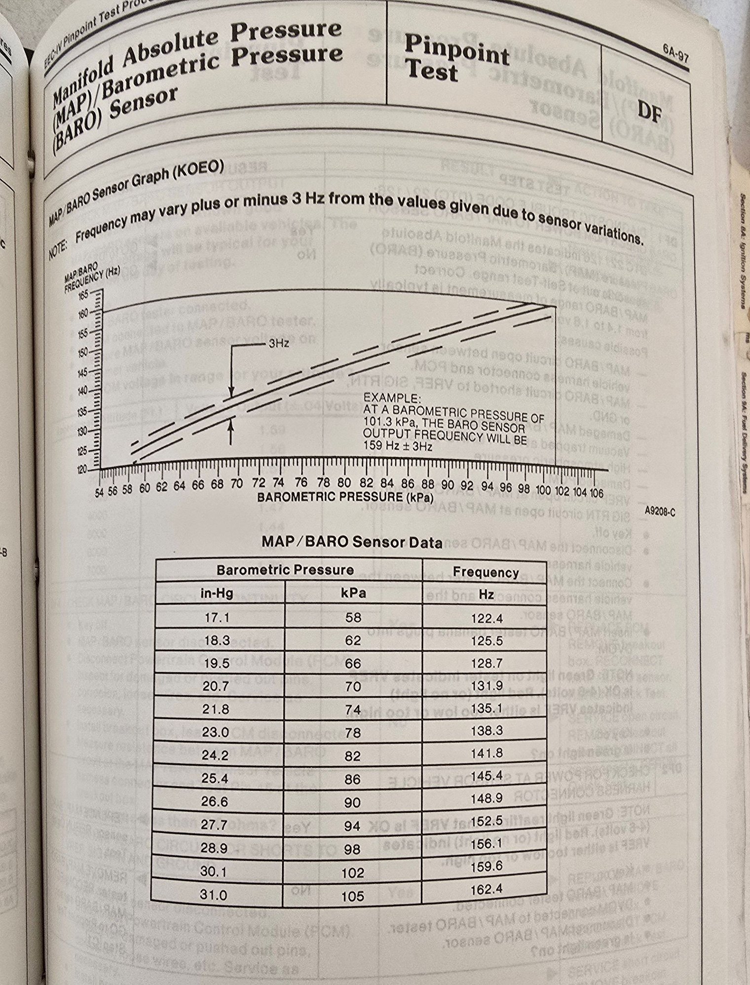

In the service manual PCED they mention a "MAP/BARO Tester" which I think is basically a breakout box for the MAP wiring. With KOEOff they expect VREF to the MAP to be 4 to 6 Volts and the sensor output to be as mentioned in the attached chart. Don't know if this is useful but ?????

The Ford PCED has you testing the Hertz from the sensor and comparing it to an altitude table
That MAP sensor is full of thick film protecting the electronics, just like the TFI module has inside it
That stuff gets sucked out sometimes into the vacuum line
That renders the sensor useless
So, the first step is to check the vacuum line for obstructions
Then
​​​​​​​Do the pinpoint tests in the PCED for that code
They will have you reading the actual Hz from the sensor, not voltage
My guess, your sensor is NFG

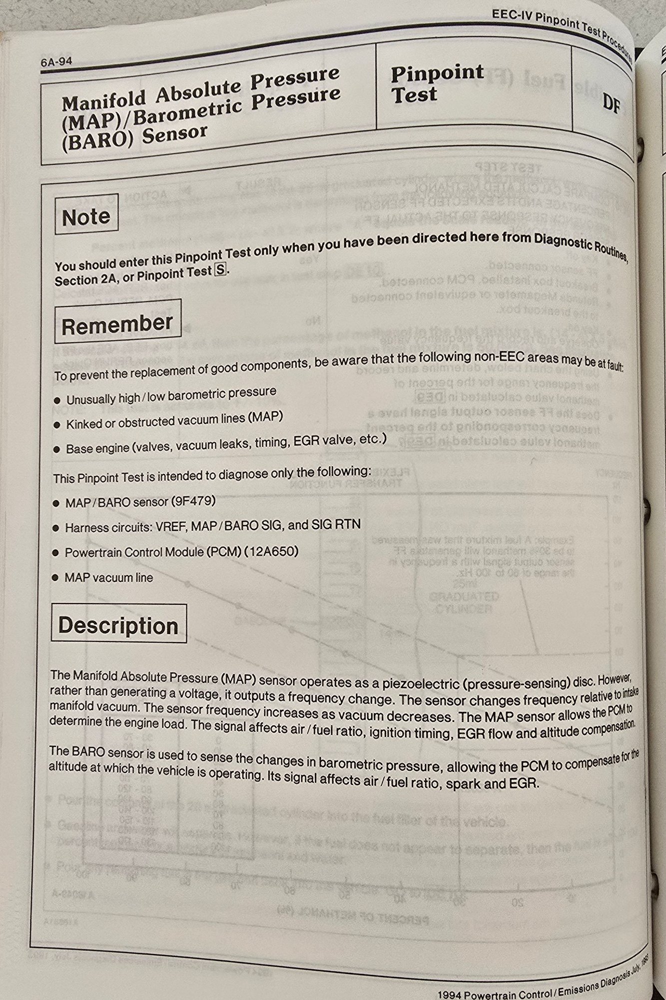

Here is some of it
If you get through these, I can post the rest

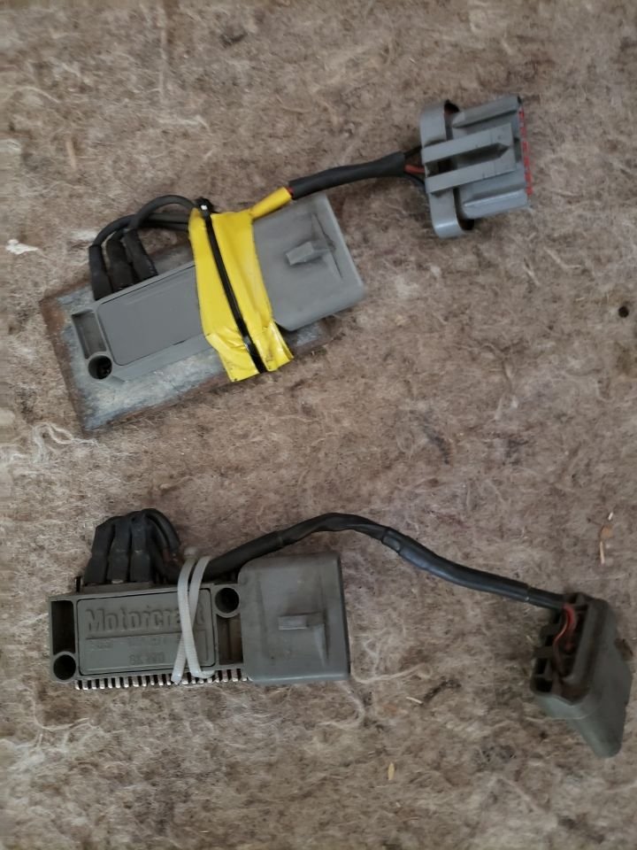

We came up with these
You can drive with a dead TFI module with one of these.
This is from an AI generated response. I think it was Gemini but at the time I was reading it, I didnt know thats where it was from, But I also found fairly similiar explanations on a couple websites.
I wish I had one of those TFI cheater things, Ive been stuck a couple times due to a bad TFI Module.
