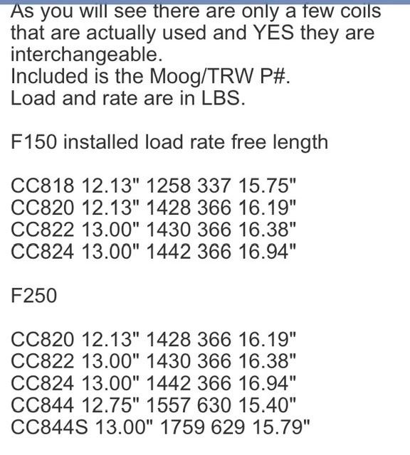

Do the 1981 F250 springs fit on the 1981 F250 without any changes to the mounting assy.
1981 F-250 springs will absolutely fit on a 1981 F-250.
I liberated this from a thread ~ 12 years ago…
As was already mentioned, if you go with a taller spring it can make it hard to get the caster/ camber back in specs.

Lots of cross over between the F150 and F250. Probably engine weight is a factor. That and GVW. You aren't going to get much softer ride. Not worth the effort IMHO.
