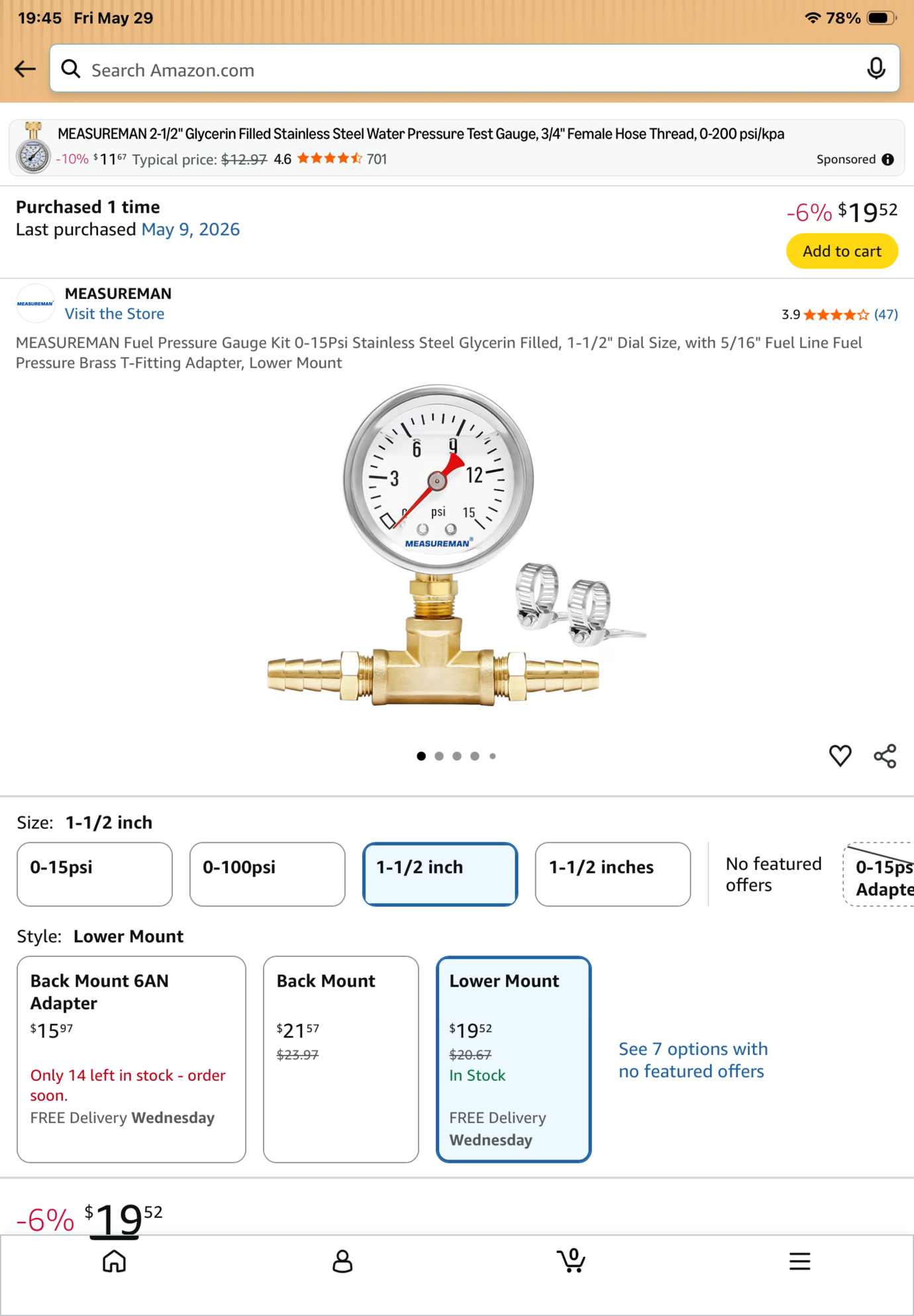

You can get something like this
https://a.co/d/01B7bYBE

That link takes you to some kind of consumer goods site like Temu or something.
It takes me to this on Amazon.

Here's a screenshot.
The link took me to a page called Super Offers. Weird.
