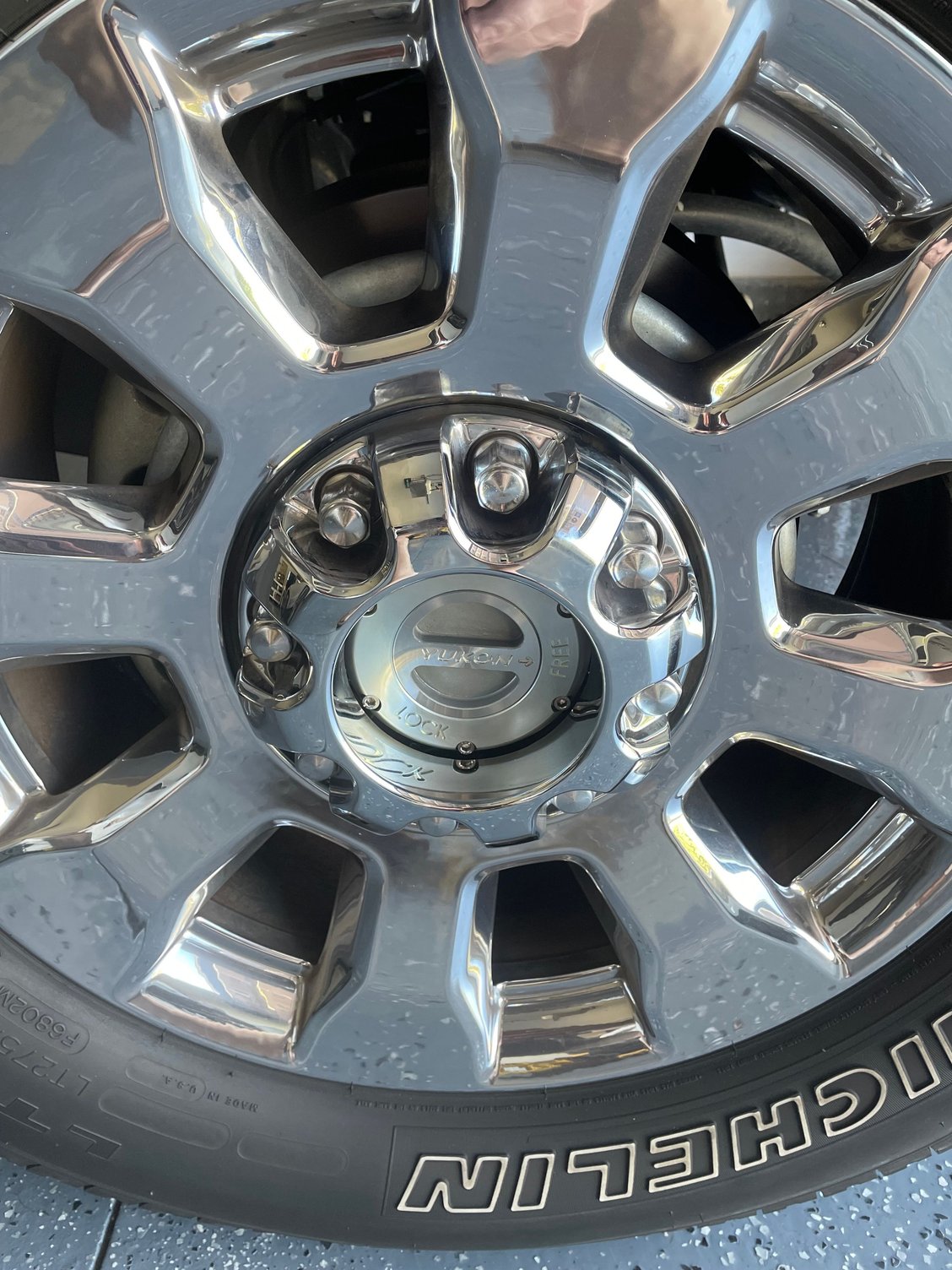

Originally Posted by Montesa
I just put Warn hubs on mine.
Did the same.
The prices on these have moved much closer together but when I did mine I went with the Ford Performance version which was ~100 cheaper than the exact same Warn parts. They even had the Ford sticker over the Warn sticker.
https://www.summitracing.com/parts/f...4-sd/make/ford
https://www.summitracing.com/parts/wrn-95060

I did the same. I figured if it had a Ford part number they can't say anything about warranty either.
