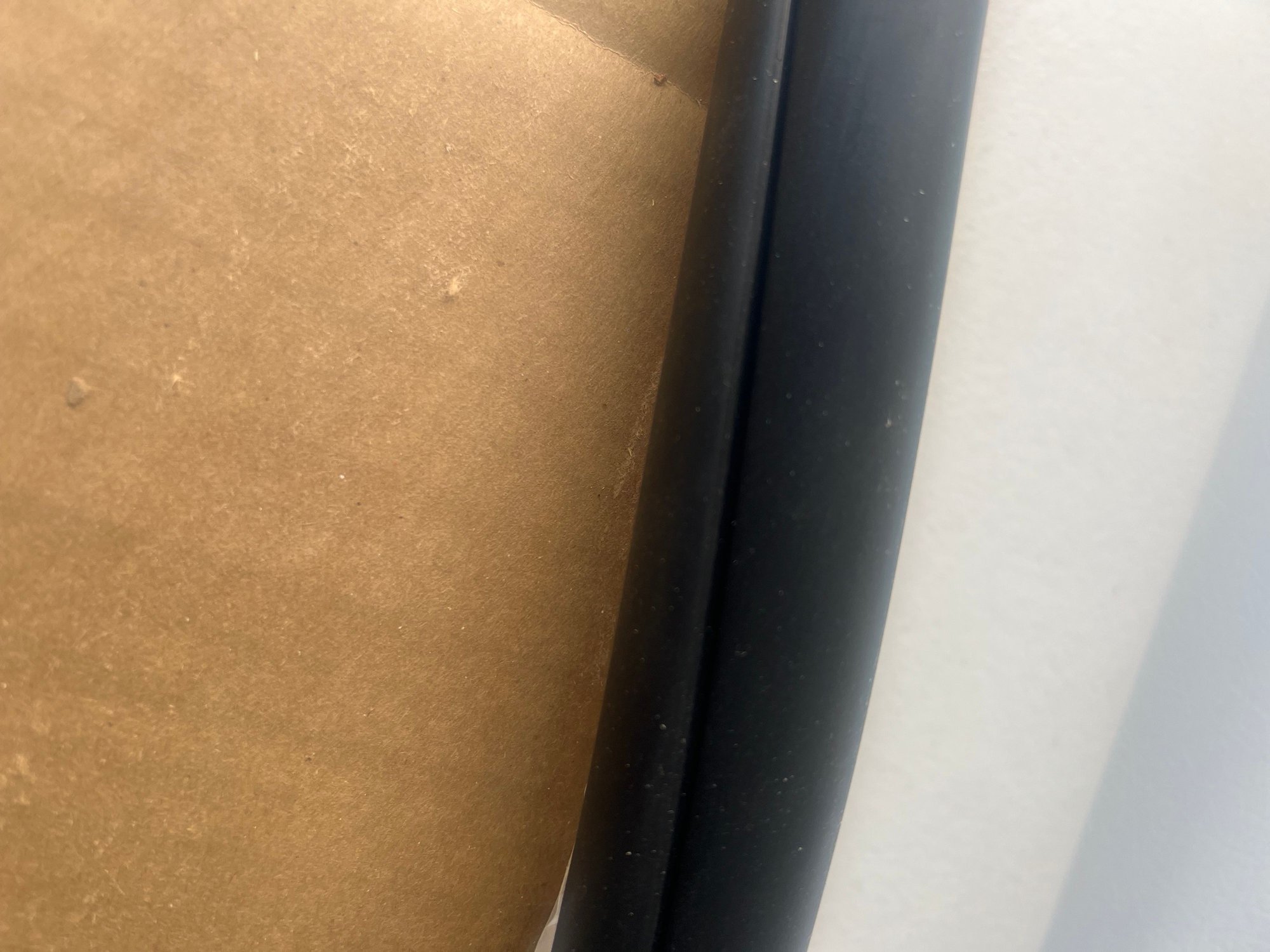

Ive been looking at the new seal and trying to figure out what is in and out and towards the window and body.
This photo is one side. Is this toward the window frame or to the body of the truck? Then there split is not centered. Leaving a small side and a big side. Which faces inn the cab and which outside towards the bed. Thanks again.

I've installed quite a few
Let us see the other side
I believe you are looking at the inside right there in that picture and the glass channel
