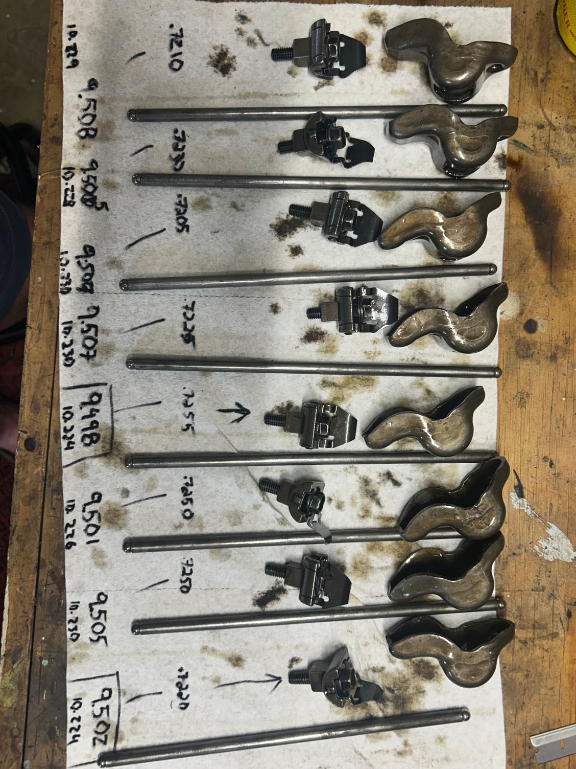

I got the micrometer and calculator out along with the passenger bank of rockers and pushrods.
Rod spec is 9.500”. No issues noted. Rod ends also look fine. I also check the fulcrum thickness. All consistent. Rocker wear looks like the example below. All are consistent.

When your engine was new those pushrods were what Ford figured would give adequate preload within the manufacturing process of all the parts and the known specs on everything. that doesn't mean much now.
Besides the wear the base circle of the cam can be a little different than your original one, put that together with all the wear, current valve stem height and any machine work and you have no idea what your preload is today. if it's all just rattling around in there that's your problem. it needs checked.
