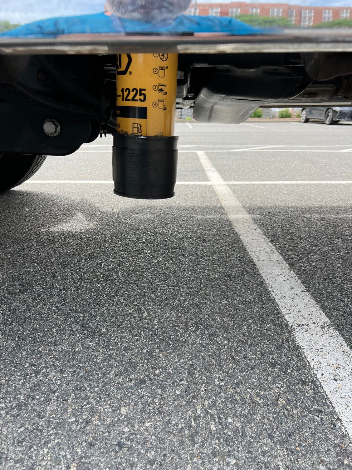

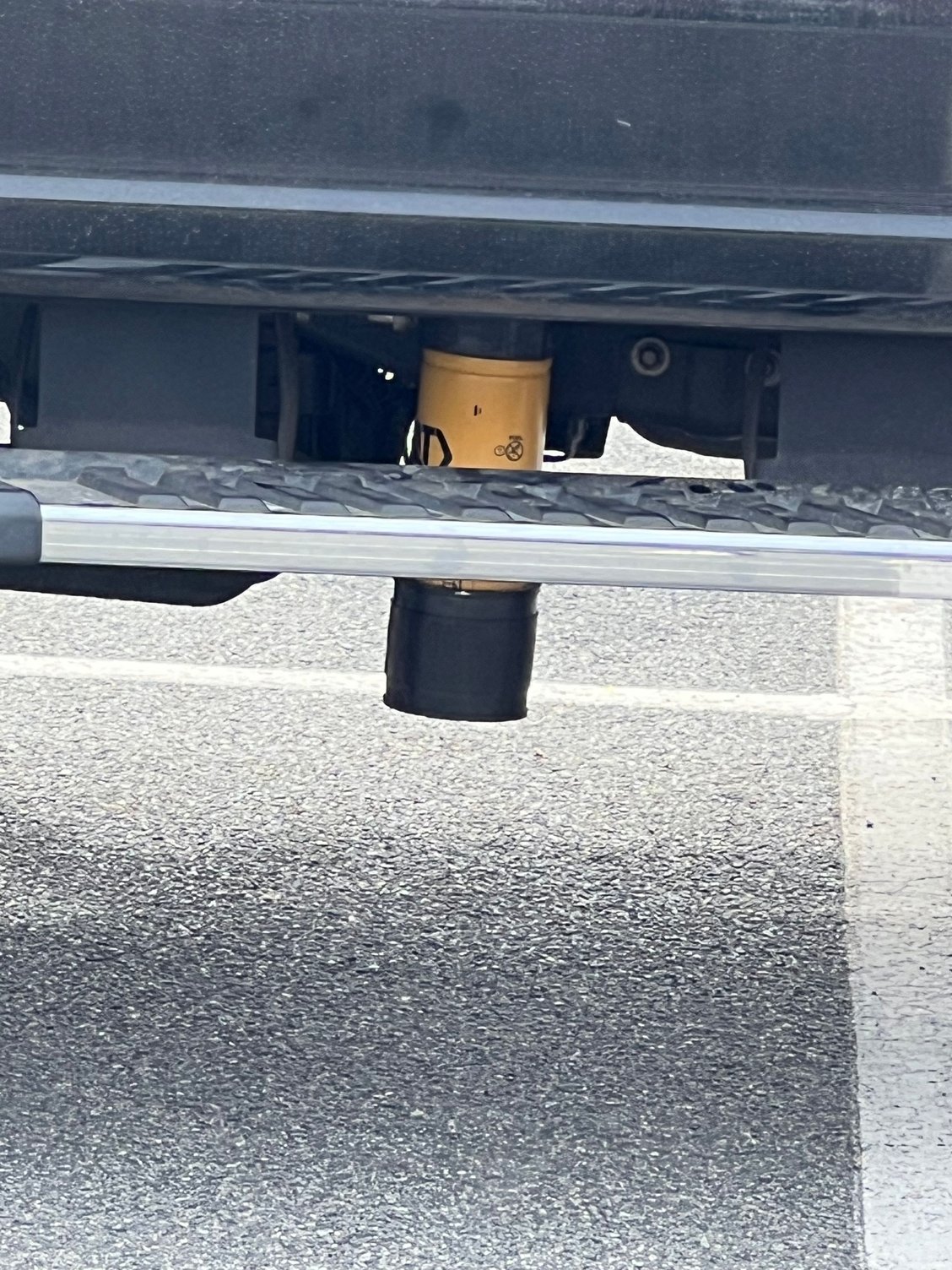

I like to use the long cat ultra high effect filters or some times the long Baldwin filters.
by the time I get to service intervals….i get a few rock chips which sometimes goes to bare metal and once did a pin hole leak.

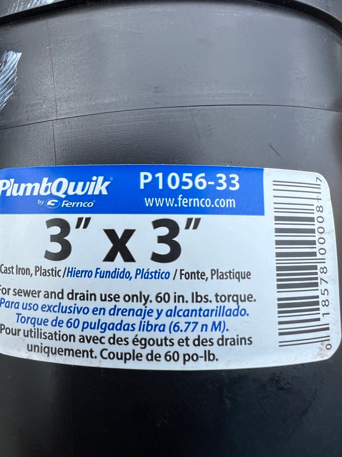

was walking thru the homedepot hardware department and saw these rubber sewer drain type pipe joints
bought a 3” to try on my cat ultra high effect filters and a 5” to try on the amsoil by pass or cat high efficiency oil filter …just to size them out.
the 3” fits perfect on the fuel filter with some hand lotion as a lube and a few light taps with a rubber mallet.
for the oil filters will try them later today.
my truck has 37@ tires and 4” lift …so even with that + 7” fuel filter tip height increase…still get occasional rock chips.
maybe this will help.

Originally Posted by Wellibe
No way in hell would I run a filter that hangs that low. That's just asking for trouble. I don't even like how low the stock motorcraft filter hangs.
Yeah I think I would be relocating that thing or perhaps rotate it 90 degrees.

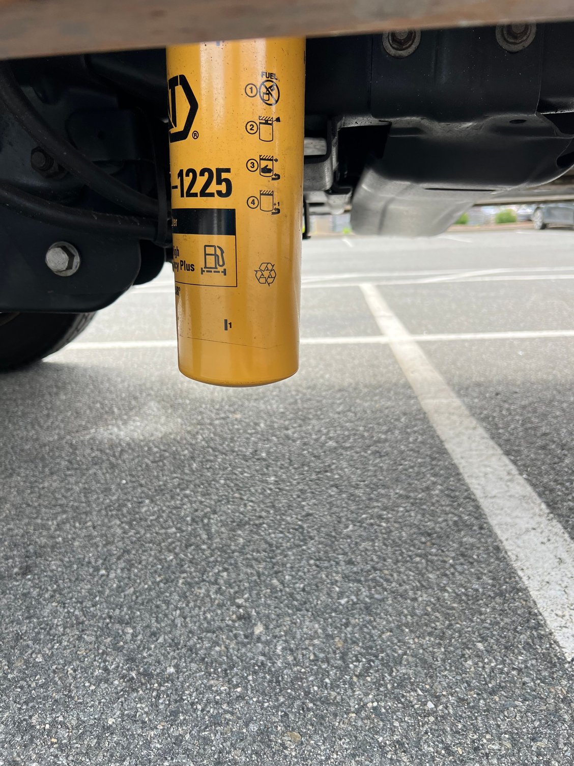

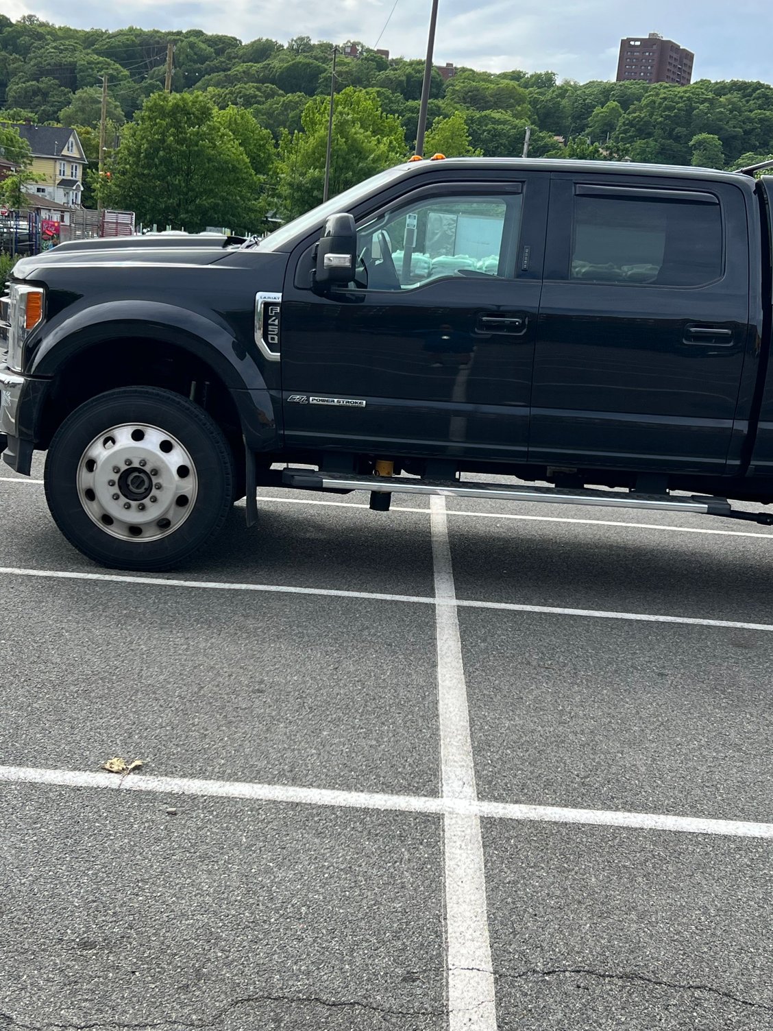

for reference, the center of the axles are about 18" from the ground and the bottom of the filter is pretty close to in line with that.
its probally higher off the ground than a stock oil filter
Are you sure about that? In the photos it appears to be noticeably lower than the radius arms, which would put it below the level of the front axle. I realize photos may look different from reality, but it doesn't look anywhere near 18" from the ground. Just looking at it, it appears to be much lower than my stock motorcraft filter.
Sorry, I wasn't paying close enough attention. I was thinking oil filter. Should have looked at the pics more closely. Fritz has a newer truck than mine, so the primary fuel filter situation isn't comparable to mine. But still, I think that filter is hanging down a good bit lower than my stock primary filter, and likely would present a hazard on anything other than smooth pavement.
