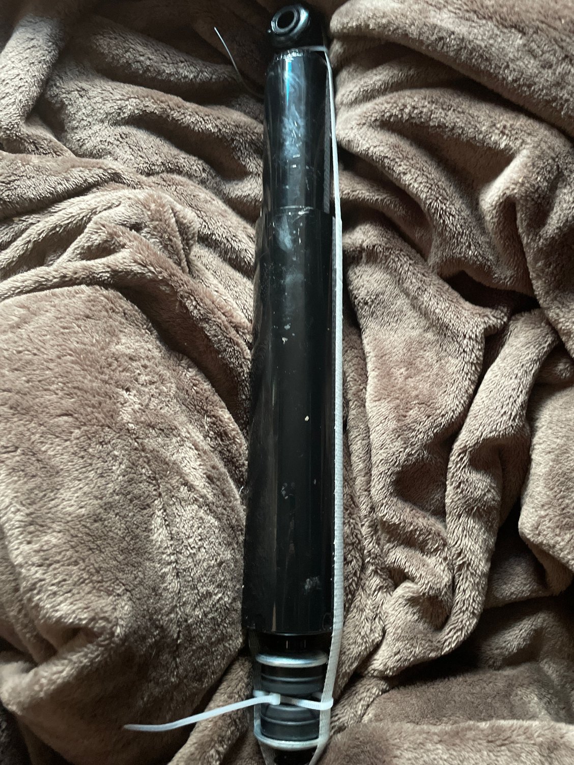

lots of play in front left tire. front right is tight. shocks are definitely toast

Sounds like your Ball joints on the left needs to be replaced. May as well replace both.

Replace the shocks, fix the play, if not the wheel bearings loose it will be the ball joints
Get that fixed and the death wobble should be gone, the tire wear might straighten out too
Usually, it is just the lower ball joint or the upper, replace them both once you remove the knuckle
I've been a front end man for 40+ years
It's actually a easy job if you know how to do it
It is time consuming and expensive
For labor, I charge about 300 a side on a 2 wheel drive and about 400 a side on a 4x4
Flat rate labor time, ball joints pay roughly 1.2 hours each

Thanks for the help guys. Bought the ball joints a while ago without even knowing they were bad. just went on a shopping spree anything front end related. Unfortunately probably bought subpar shocks(equivalent to what’s already on there atleast) so will have to wait for the new ones to come to do it right the first time(going with KYB) got quoted 500 and 800(different shops) to install both. the $500 quote is the one that has been fixing everything now. so good deal I guess based on how much you’d do them for?

Any new shock will feel better than one with 260k miles on it. I'd jump all over that $500 labor charge for two front shocks. Radius Arm bushings still good? I'd definitely look at those. Sway bar bushings ok too? Now that you're down there may as well look and replace bushings. The parts are cheap. The labor OTOH....$$

$500 for joints and shocks. adding pictures cause i dunno. first 2 pictures are front left and 3rd is front right

Looks nice and clean underneath there. Doesn't look like they will struggle with any rusted bolts.

Right, you are not getting your ***** broke at 5 beans
The KYB shocks will be fine
Those cams in the upper ball joint are the stock factory cams that are round
Replacement ones from Ford et al. have a hex head
The alignment guy might want to change those
I doubt the camber / caster is correct still with those factory cams in it
