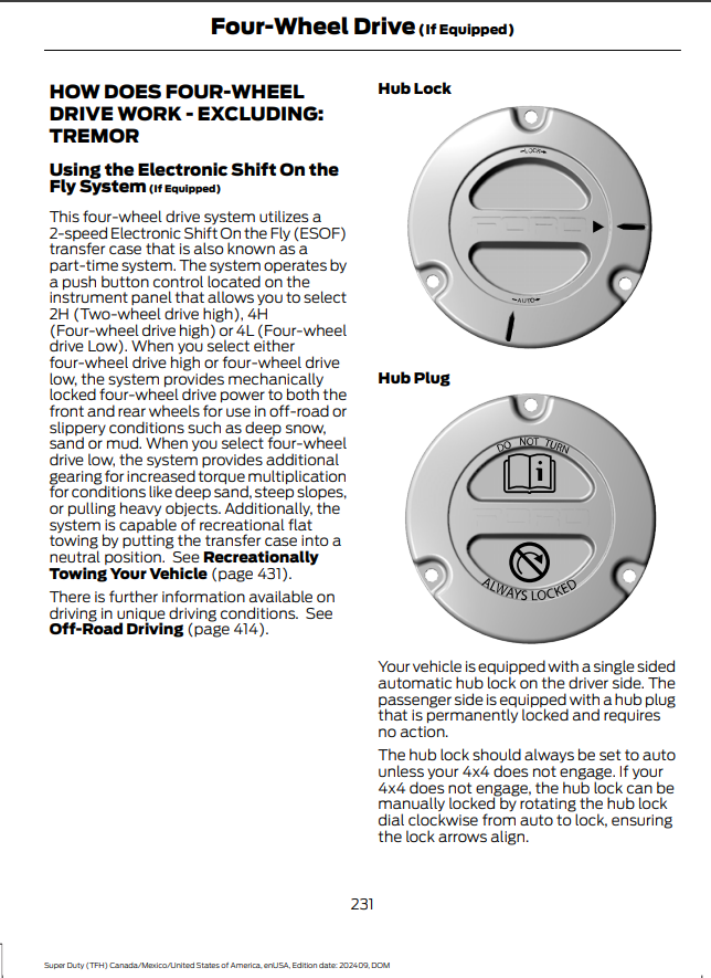

I have a 2025 F-350 XLT 4x4. I was looking at the manual regarding the manual hub locking function. This truck has hub locks on both sides, while the manual (page below) states it has a "plug" on the right side. I'm assuming the manual is wrong, because I don't have a Tremor and it seems to only show a passenger hub lock on Tremor.

Yes, tha manual is wrong. Ford put a dummy hublock on the previous year but reintroduced it for 25

Thanks! New to Ford SuperDuty, finding there is a lot to learn.
