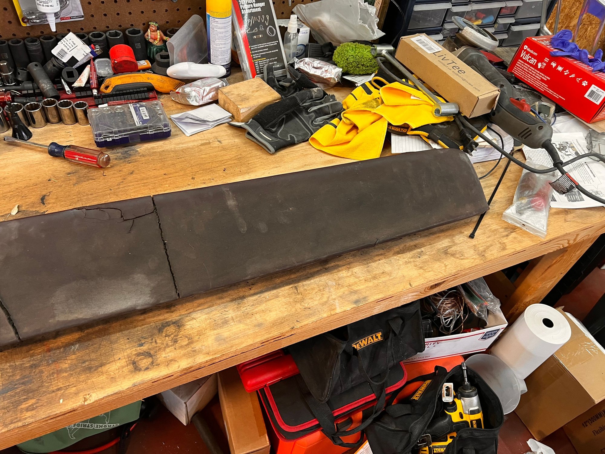

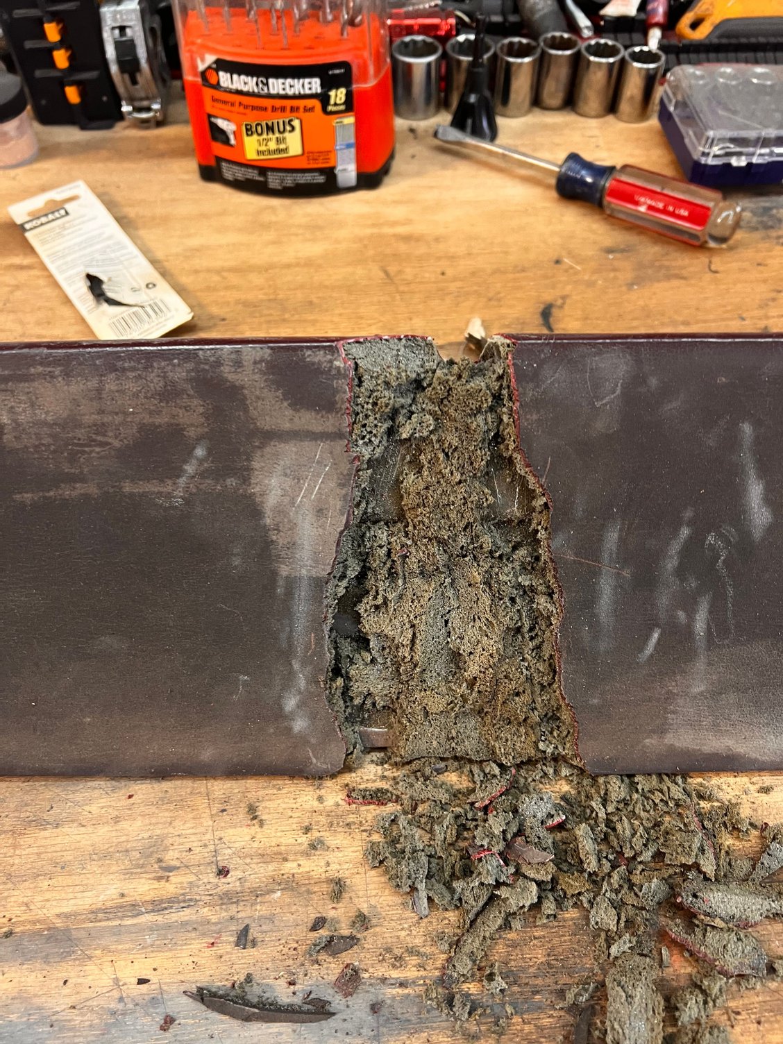

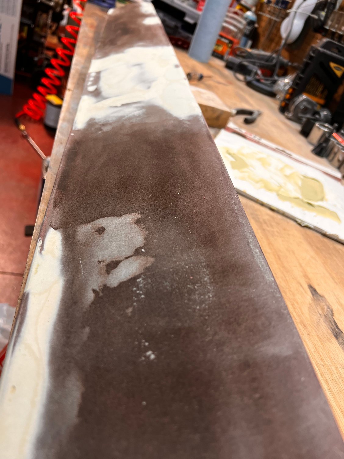

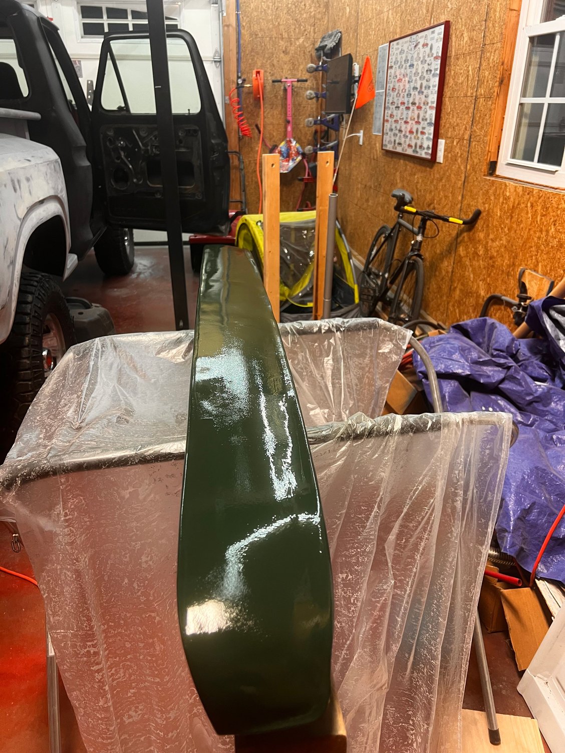

Dug out the brittle foam and replaced with bondo. Primed and painted.
