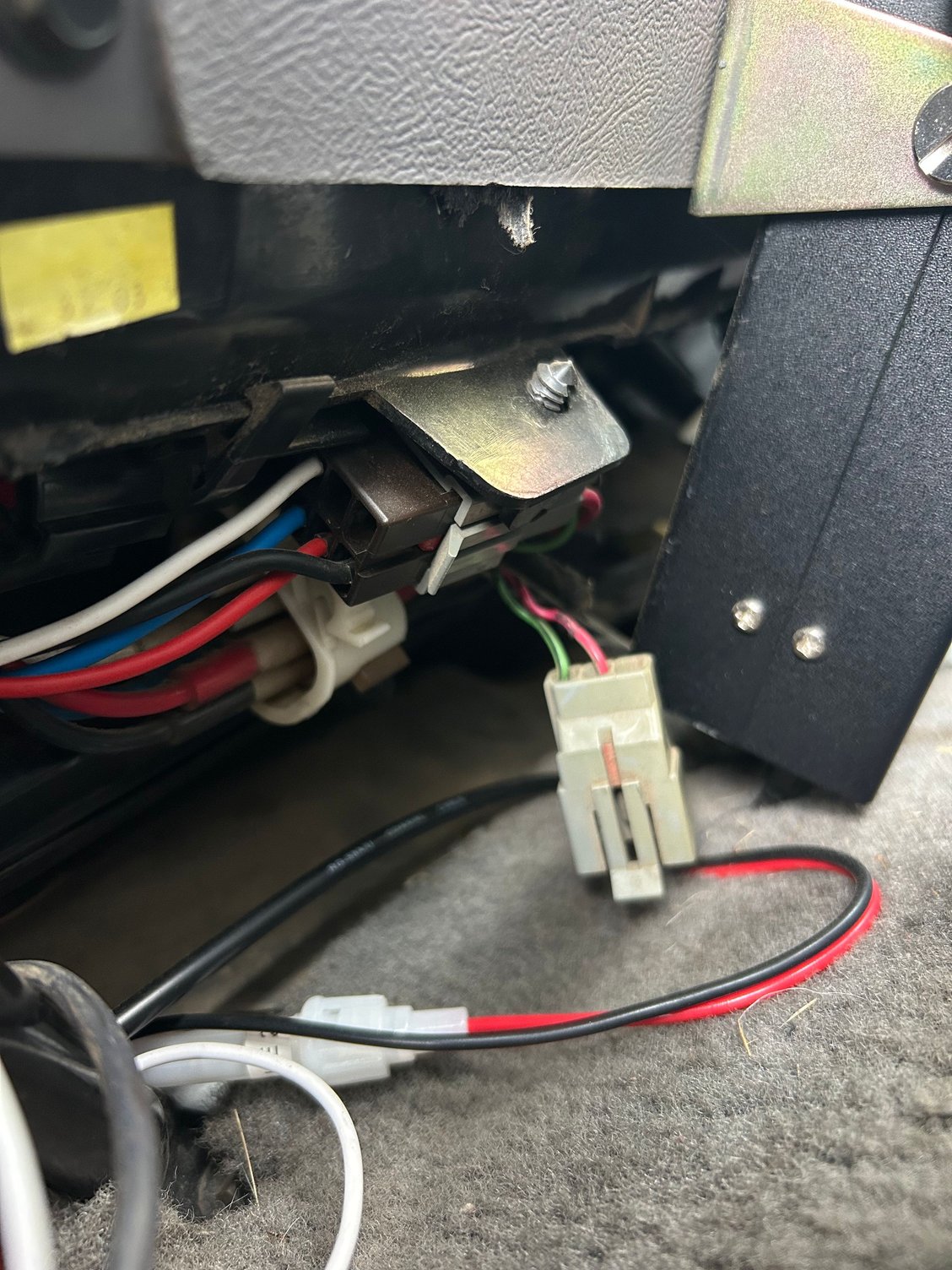

I mustve misunderstood the wire you were talking about orignially. The photo below is the daisy chaining I was meaning. The ground seen in that photo does not go to the brake controller.
Ill take a better look this weekend.
