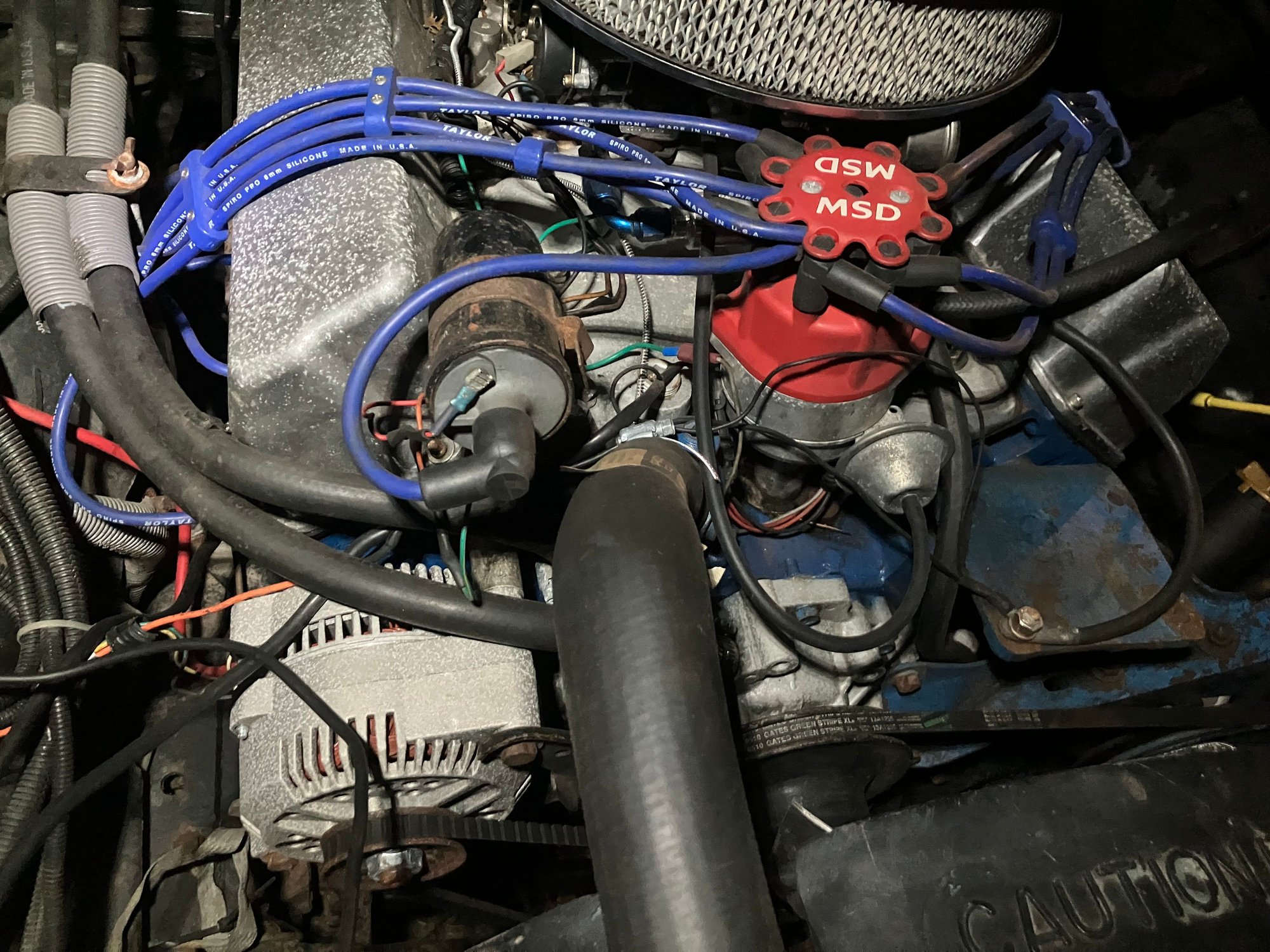

Blue grommet. 2 plug DS2 module.
It’s chinesium, been on there about 5 years and I’ve been wanting to replace it with a heavy duty US-made module for awhile.
It’s firing a built 400 with a stock coil and MSD distributor.
What’s the best heavy duty US made module available?
thanks

It is an MSD RTR.
I was all set to go with a 6AL box, but was talked out of it by someone pointing out that my duraspark was all original with a 45 years and a gazillion miles on it.
stand by for pics

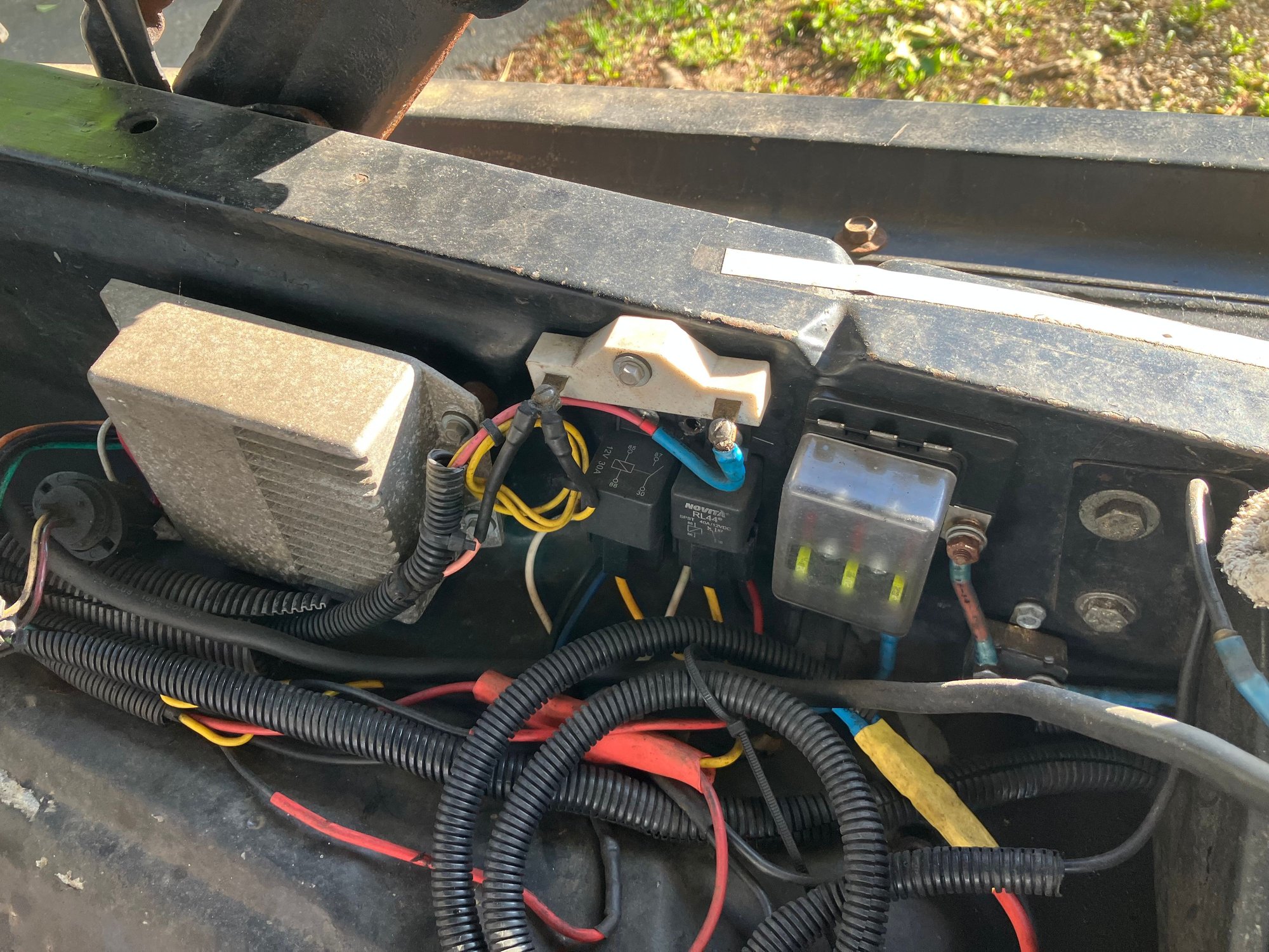

https://www.ford-trucks.com/forums/1...gn-module.html
I just made a ride along spare from junkyard parts, see photos in link above.
Jim

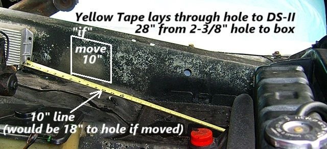

I have two tested & stored open side up boxed behind the seat.
One was behind the seat for many years and the potting run out into the box while just stored, it was a mess, but it worked to get me home when needed. I cut the potting / cardboard mess away, might yet refill it with J B Weld. Other one is new and then there is the one under the hood.
I did work out a plan to ease life under the hood for it, like mount it 10" closer to the front and pipe cooler air to it from a hole no longer used for AC lines to the condenser.
Not shown is idea to twist it to open side up.
