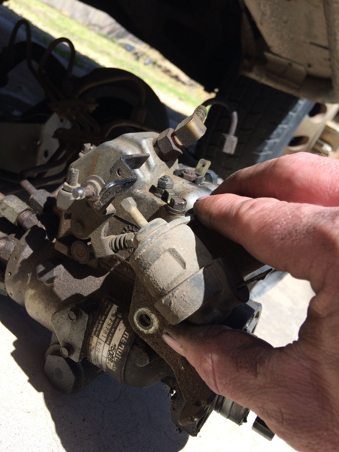

I haven’t quite had the issue your describing but you might be able to adjust the idle screw on the throttle back down. Also, make sure you throttle cables are letting the throttle go to idle and make sure the spring on the throttle control on the IP is on there and pulling it back to idle position when at idle. Also make sure the plunger on the fast idle solonoid is not holding the throttle open more. It should only do this when cold.
Turn the screw counter clockwise to slow engine down a little and give it a try. Back it off one turn and see how fast it idles. I think idle speed is around 650-700rpm.
Also, does your truck roll smoke while driving? Are you sure he turned the fuel up or could he have just turned the idle screw up? If he actually turned the pump up, it may be pouring in more fuel then needed especially if it does not have a turbo.
A small turn of the pumps fuel adjustment screw goes a long ways. Usually we only go a flat or 2 on an Allen wrench which is only about 60-120 degrees turn.
Here is a picture of the idle speed adjustment screw.
here is a picture of the fast idle solonoid Attached to the pump. The only time the fast idle should be pushing on the throttle is when the engine is cold.
