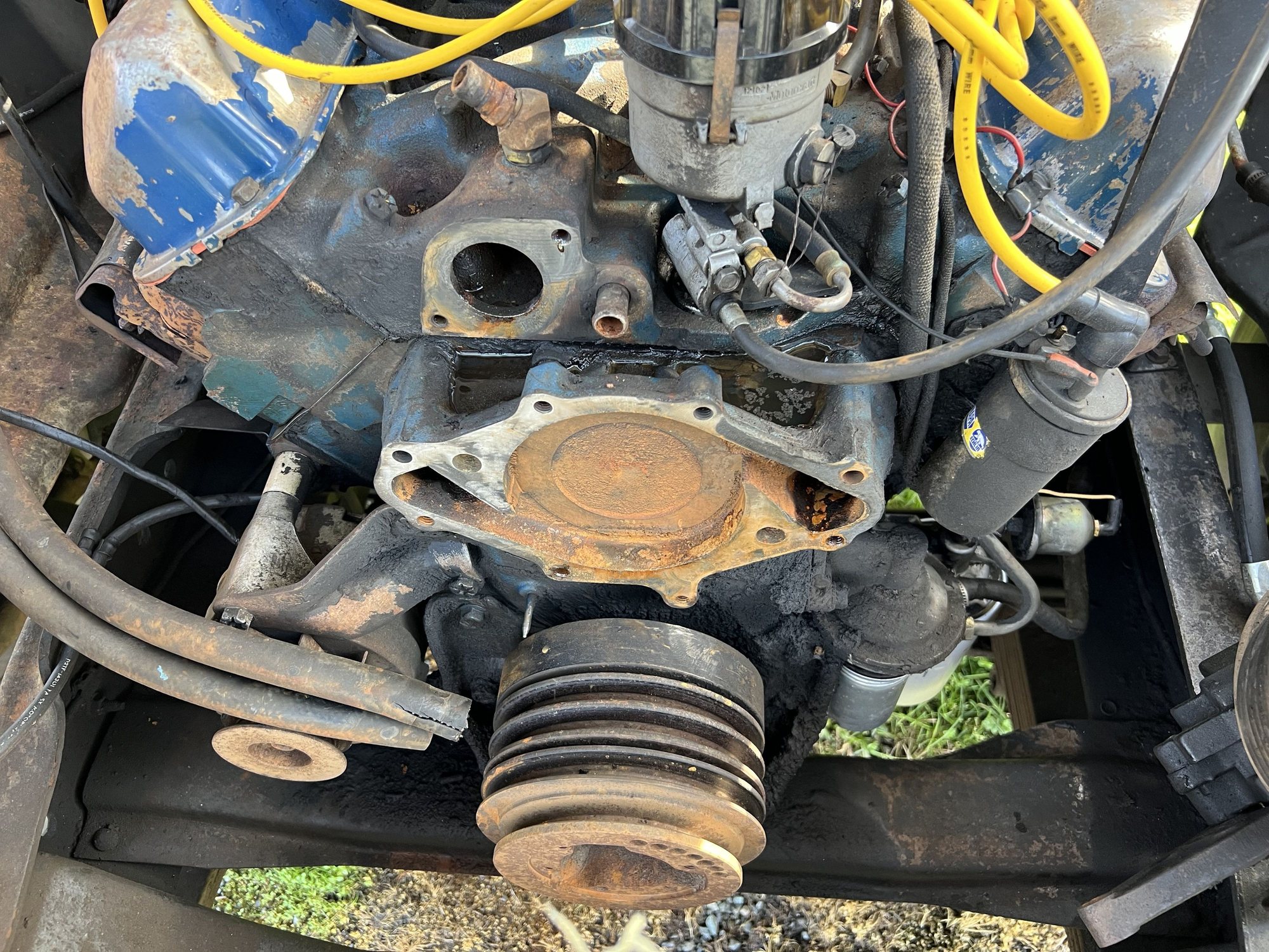

If you have the 330HD then your lower hose is a three-piece setup, with a short straight section, a metal intermediate section, and either a straight or curved lower section:
What I pulled out of my '73 w/361:
What I replaced it with (before I installed a Chinesium radiator and had to throw this away and start again). This was NAPA NBH 7244 (and my notes said that it's probably Gates 20424). It fit reasonably well but not perfect:
Note this will only work if you have a 330HD with a water pump that mounts to the timing cover, like this:

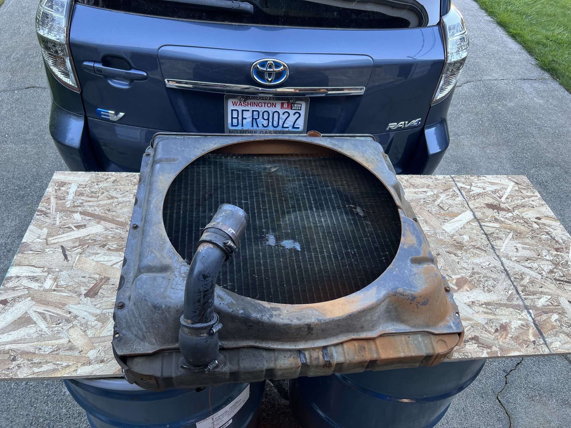

Yes, I have the 330HD. And I have the 3-pc lower. I ended up putting a straight section of hose on both ends of the steel section, but I don't trust it to not blow off (probably won't, but I still don't trust it), and I think that it's putting unnecessary stress on the lower tank outlet because that short piece of straight hose really doesn't want to bend. Your NAPA hose looks to be a much better fit than what I'm running with right now.

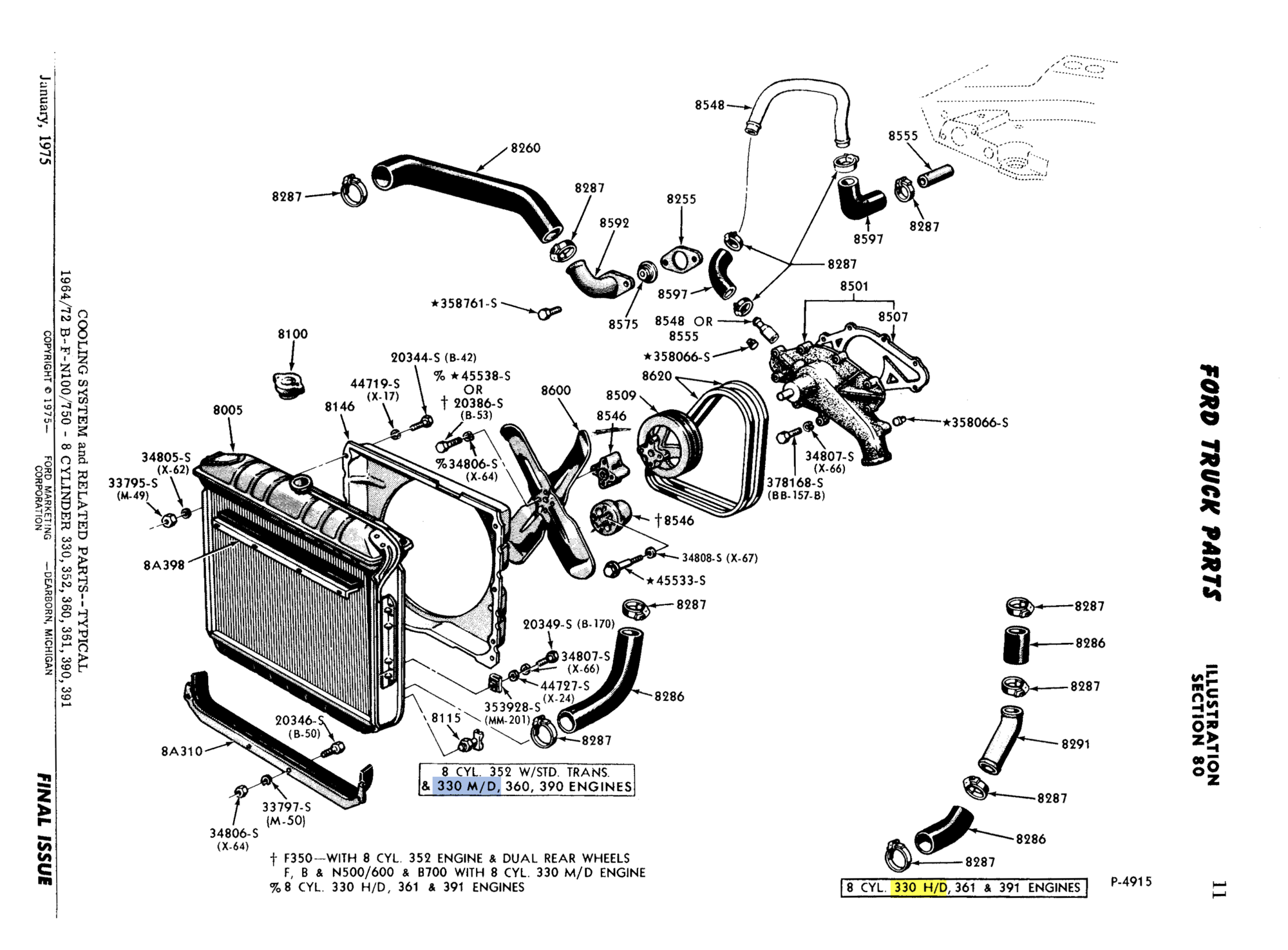

There are (16) pages of radiator hoses in the MPC. MT vs AT, PS/no PS, and serial number ranges sometimes matter, as well as the year, but the FT engines are only spread across three pages, lol. I figure it's time to concatenate all the FT radiator hose on one page. Turns out, for your particular combo (1969, 330HD, F600) there's only one line that fits:
The upper is KM200 (molded hose, 1-3/4" x 20.0" long) aka C4TZ-8260-D. If you chose an (optional) flexible hose, that would be KC110 (1-3/4" x 11.0") . IDK why a flexible hose would be 9" shorter. The '●' preceding the KM200 indicates to use the flexible hose if the molded hose is not available.
The lower "pipe to engine" is KS4 (straight hose, 2" x 4") or bulk hose 51A-8333-C
The lower "radiator to pipe" is KM119 (molded hose, 2" x 12-1/4"? (119 is 11" + 9/8" ?)) aka C9PZ-8286-F replaced by DCPZ-8286-E, and cut at marked points 'A' & 'B' on the hose.
You'll want to double-check what I wrote against the source above, as I make misteaks.

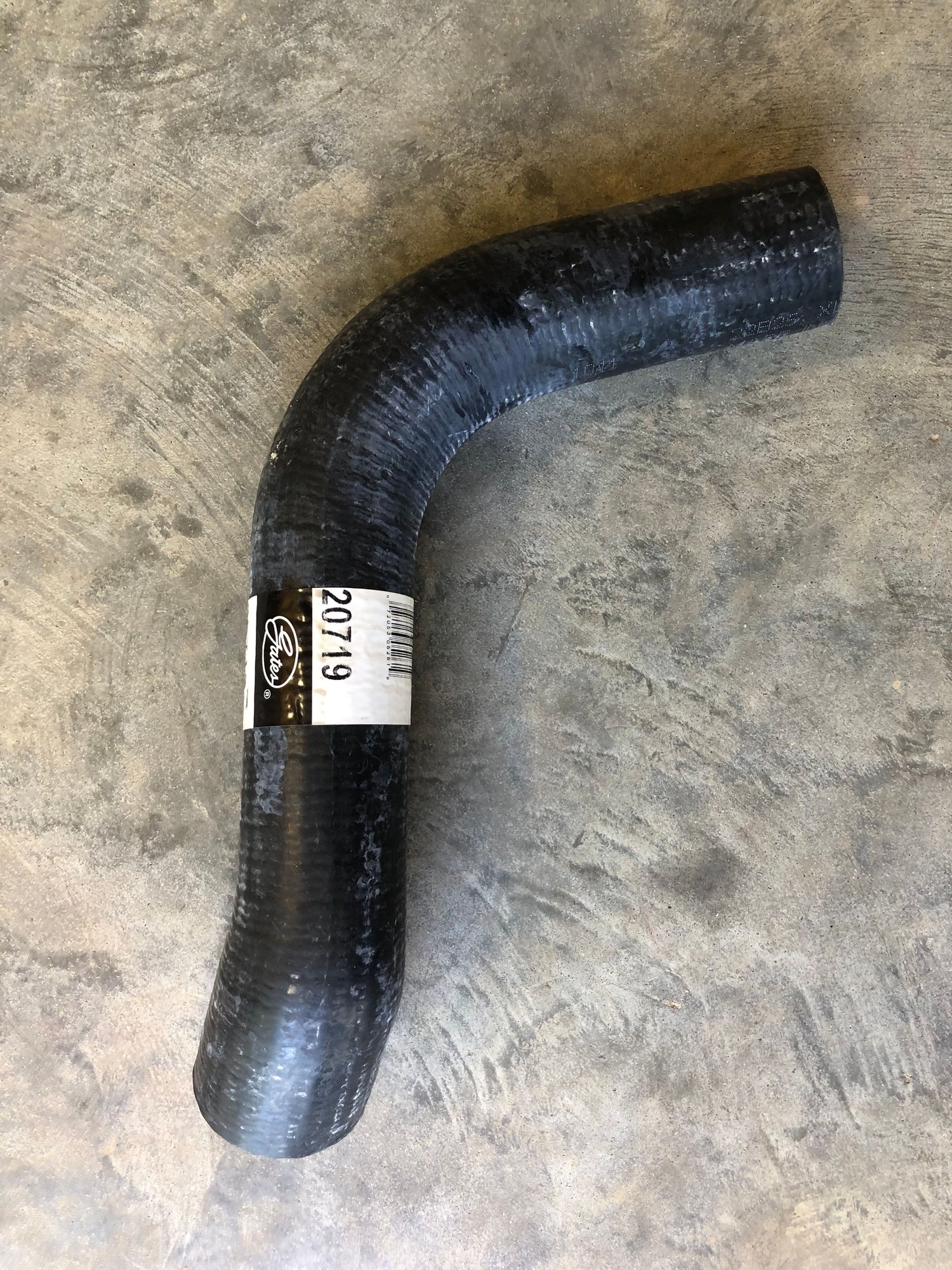

Finally!!! Got an upper hose! Went to a metal fab shop to see if they could bend a pipe for me. I was planning to set the upper up like the lower. They work with heavier stuff, so they couldn't help me there, but the boss and secretary where nice folks and the secretary googled the part numbers I had and came up with 20719. Same as one of the part numbers you sent me. So I ordered it and it worked.
In summary:

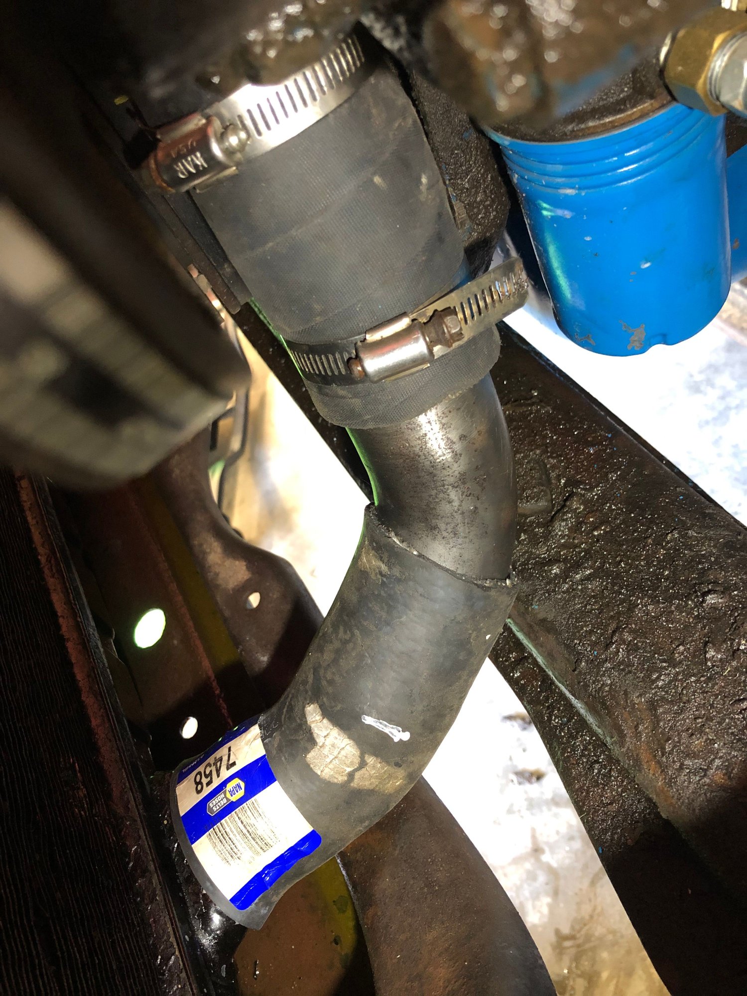

LOWER FORMED HOSE - NAPA 7458 (Trim to fit. I cut it off just behind one of the bends, leaving enough straight length to be safe. After installing, I found that I could have cut off probably another 1-1/4 to 1-1/2 inches. I left it as is since it was a pain to install and would be even harder to remove. I'll know better next time.)
UPPER RADIATOR HOSE - Gates 20719 (I trimmed about 1/2-in. off of the thermostat side to remove the hose kink).

The white line on the lower 7458 hose is where the metal tube ends. There was room for more trimming. And yes, I did put hose clamps on after I got done with the pics.
