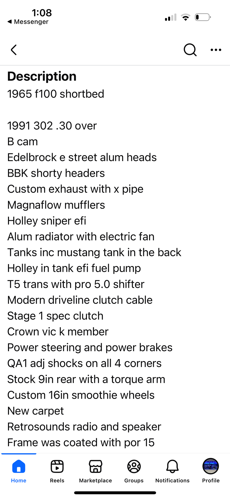

Old May 9, 2026 | 12:08 AM
epleeds's Avatar
epleeds
Joined: Nov 2020
Posts: 118
Likes: 17
Old May 9, 2026 | 04:03 AM
The Dassler's Avatar
The Dassler
Joined: Jan 2025
Posts: 508
Likes: 198
Don't have any knowledge about '90's 302's, so I can't offer any advice, but the write up reads like a pretty slick Slick. Not sure we have seen any photo's, so start sharing, pictures are always welcome, and that way we can share in your enthusiasm or nitpick the small details for fun...just kidding, this is your truck and last time I heard, it is up to you what you do with it, but there are lots of folks all over the board with ideas, and maybe something you have done will inspire someone less far along and encourage them too.
Look forward to reading the final outcome of whither or not you need to do the additive thing, but leaning some good things in the process.
Old May 9, 2026 | 04:24 AM
Crop Duster's Avatar
Crop Duster
Joined: May 2015
Posts: 4,474
Likes: 974
From: Tri Cities, TN
I would have to assume by B cam he means a Ford Performance M-6250-B303 cam. That is a roller lifter cam and there is no need for anything more than a high quality off the shelf oil. I would use whatever Ford recommended for a 91 Mustang 5.0.
The stock 5.0 cam is 266/266 duration and .444/.444 lift the B303 cam is 284/284 with .480/.480 lift. I had one in a 1988 5.0 that was converted to a carburetor, and it is a strong running cam above 4000 rpm but is pretty much done by 6000.
