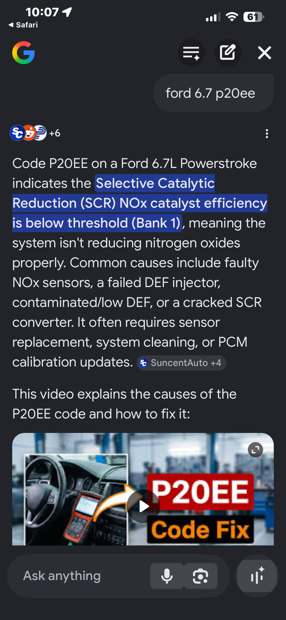

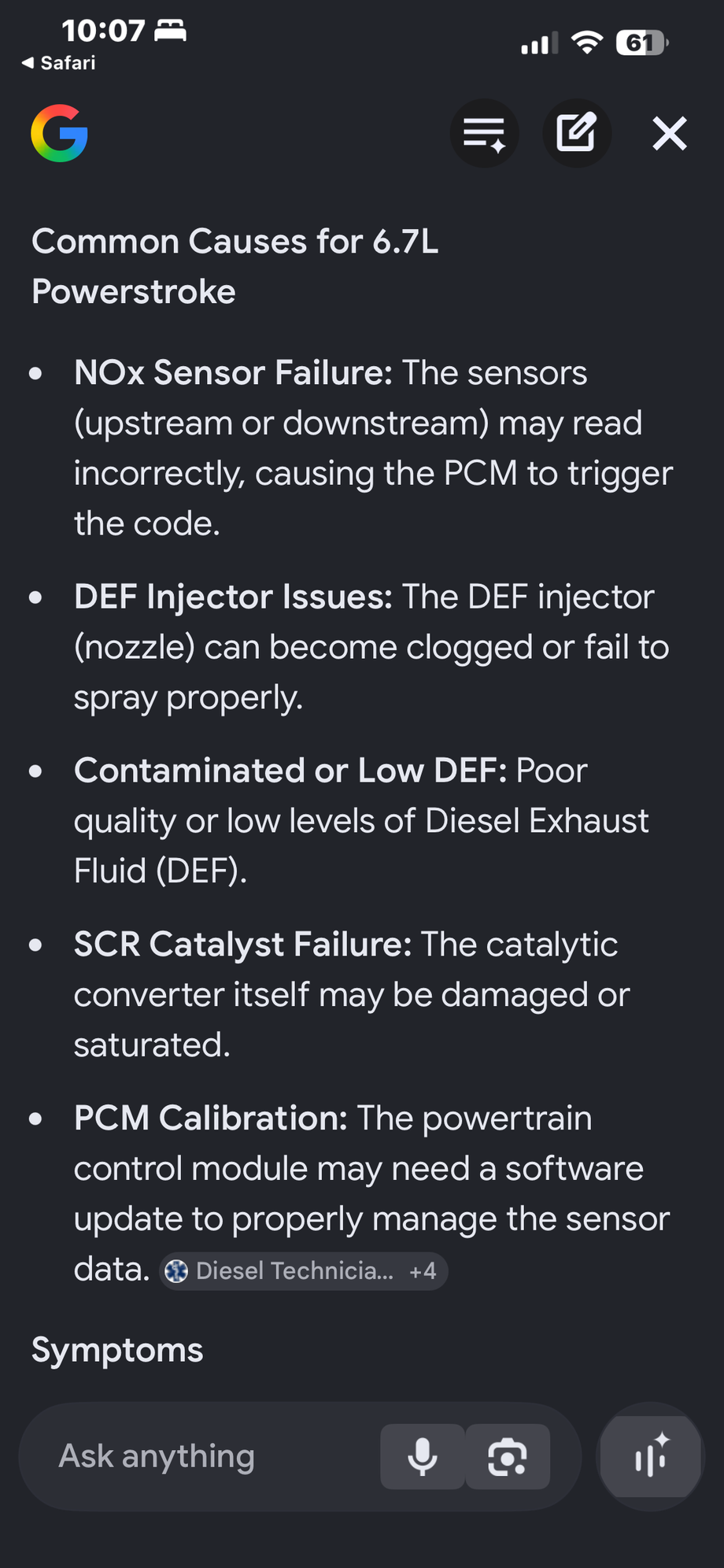

yeah I have been doing plenty of googling. Just wondering what other people’s experiences are and what fixes they have had to deal with
