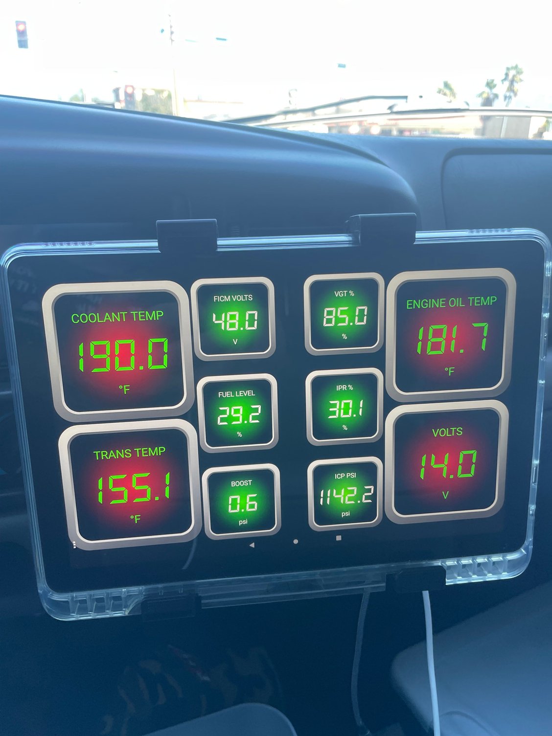

You could also buy an inexpensive tablet and mount and have your own custom gauges. I use a different program than most but it has worked great for many years. If there is a PID, you can build the gauge.
It is much larger than my last 8" but I personally love it and it gives me all the info I need. The system I use allows for 3 pages of gauges, so the subsequent are small to fit more, but I have every PID monitored I need.

I like it, but I would still have to spring for a tuner.
Is that strictly OBD data, or can you also somehow get data from aftermarket sensors?

I can do a little interfacing, this is the app I use:
I did pay a one time for ALL of the PIDS for my truck.
