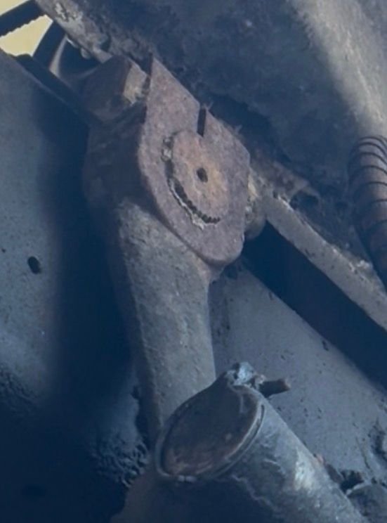

I realize there will always be play, but I think mine is excessive. I’m thinking it’s coming from this part here, after the gear box. What do you think… I can’t seem to find any pitman arms with a pinch bolt style system. As the video shows, I think the joint closest to the ground is worn out.

Sorry for the non stop questions. I just noticed the whole control valve rotates when I wiggle the steering wheel. It has play at both ends and rotates at these points left to right.

That play is 100% normal at that location. There is a spool in there that is simply sloppy. Highboy steering is very sloppy and prone to wander, nature of the beast with ram assist.

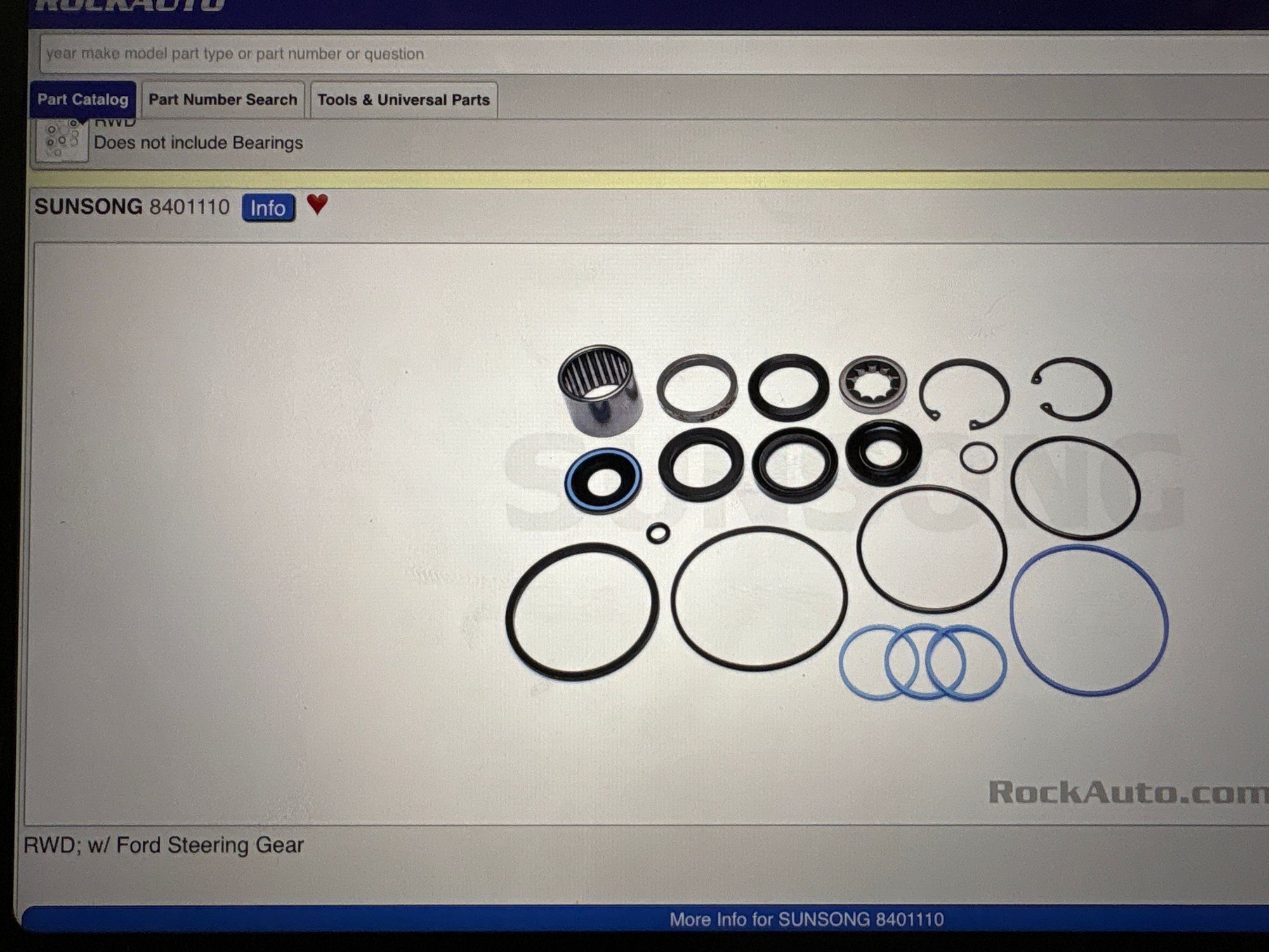

Do you think a rebuild kit for the box like this would repair the gear box to new condition? I notice it says rwd, but all the kits say that

It would help but it won't ever be like new. The gear parts are where the slop is most likely from. Thats why I spent the money on redhead. They actually make it better than factory
