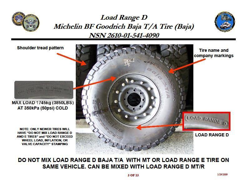

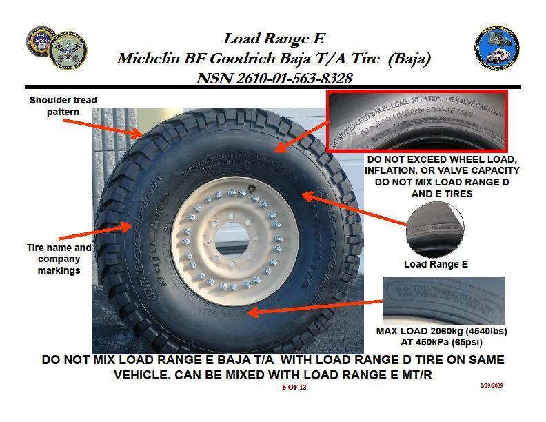

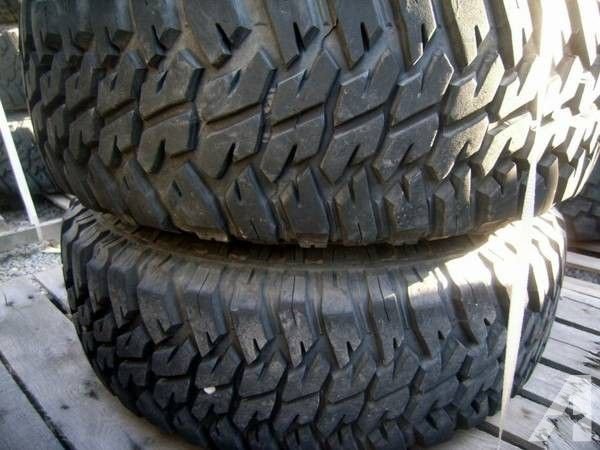

1st gen HMMWV tires are BIAS ply Goodyear Wrangler R/T II and are 36x12.50x16.5. Horrible wet road manners.
2nd gen are radials and Goodyear Wrangler M/T 37x12.50x16.5. And are 80 lbs a piece (just the tire). HEAVY
3rd gen are also radial BFG Baja TA and a MT/R version 37x12.50x16.5 . Come in 2 different load ranges.
https://feltztire.com/product/37x125...0-ply-old-dot/
Trail Worthy Fab has some grooved 2nd gens. https://trailworthyfab.com/products/...hoCXwYQAvD_BwE
Simple tire Enforcer MT https://simpletire.com/tire-sizes/37...kipGroups=true
