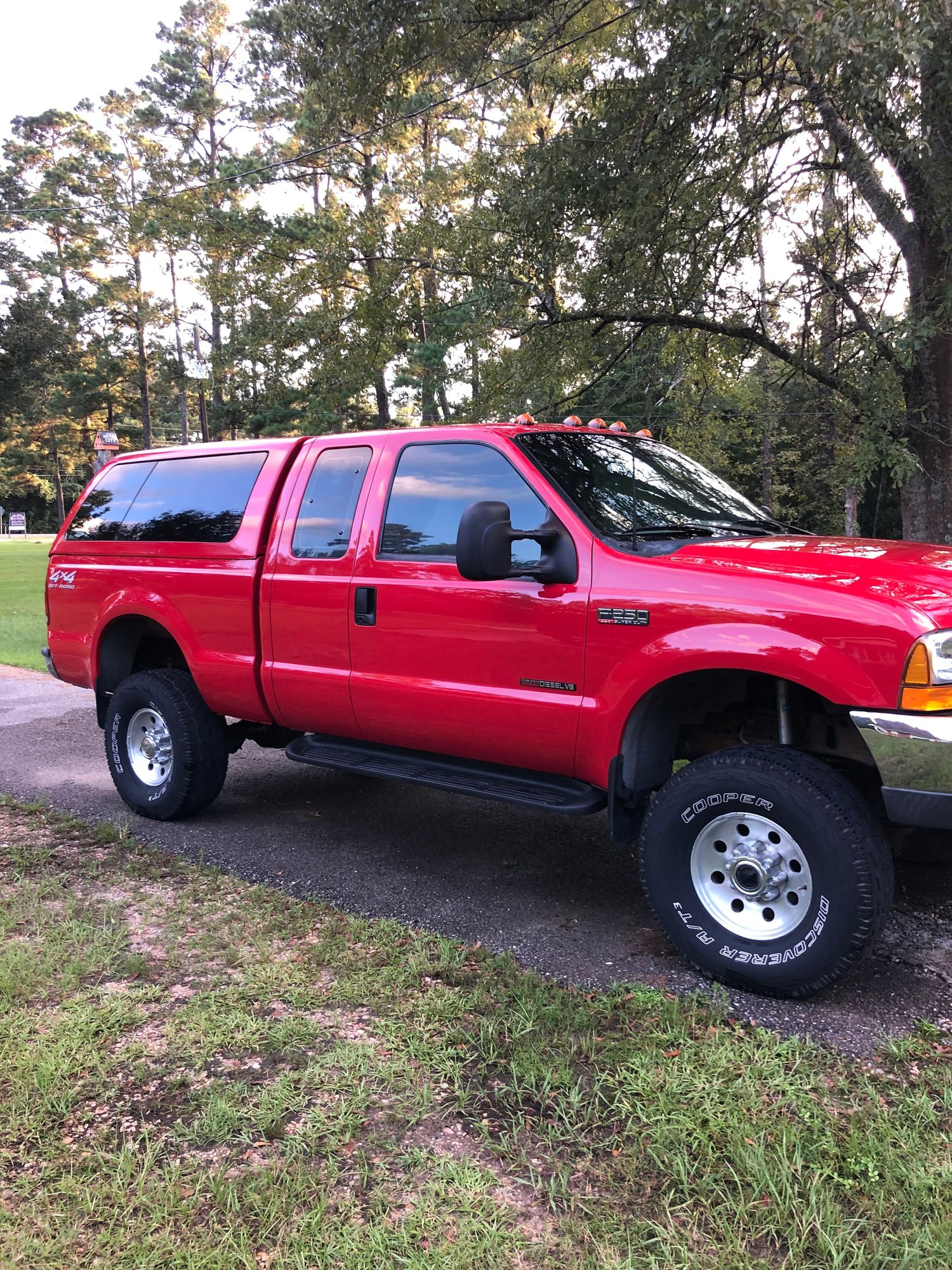

Hey guys I have 8 ad injectors in my 2000 7.3. Been wanting to put the ae back in. Should I do that or tune around the ad in #8. Doesn’t seem to run the same as when ae was in. Does it even matter? Was told it didn’t was just a little noisier……. Any advice? Truck has 345k. Only new injectors and turbo . I keep her pretty stock. Thanks
