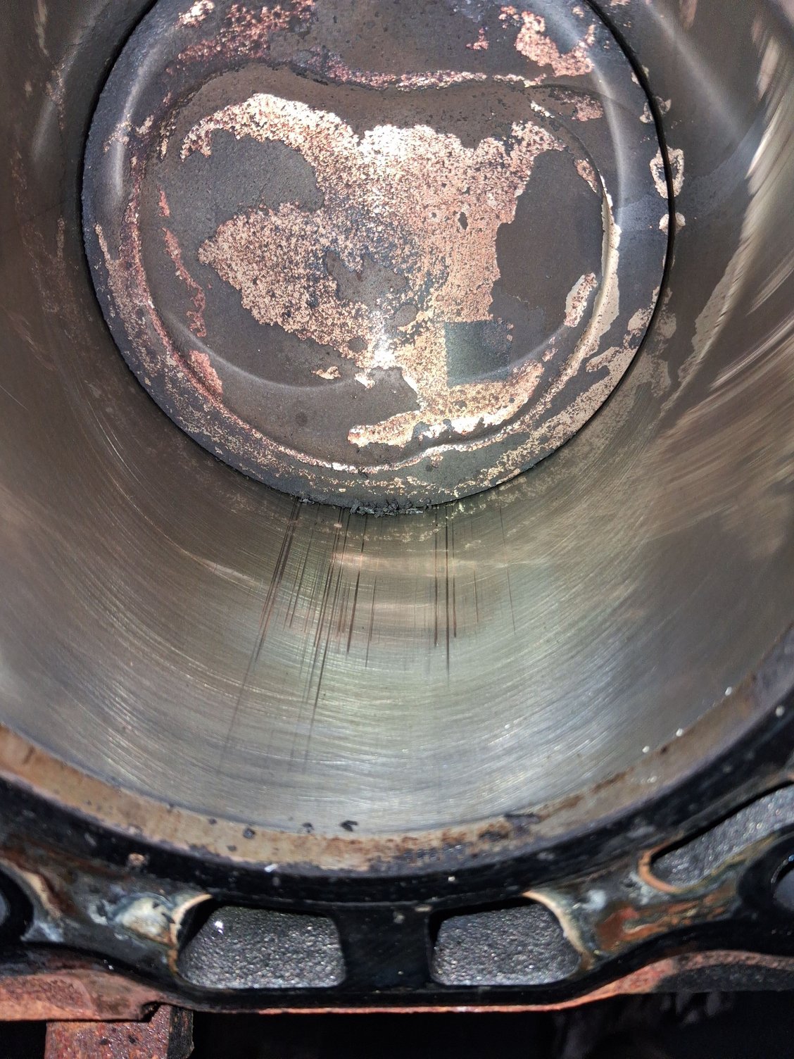

Yes, possible lifter failure

Through software updates, the 2024 "should" be more immune from the lifter tick, that was 2020-2022. Though a hardware re-design was not introduced until 2026MY. Lets hope it's not that. It usually wrecks the entire top end.
Would be good to get the idle hours on this one. 41k failure really sux.

It was in a tow truck. The only other 7.3 we've had to replace in 3 1/2 years was also in a chassis cab as well

Likes: 119
However, the tow truck complaint was a tapping noise on the passenger side. That's cylinder 4. I hope it's not for OP's sake; let us know what they find!
