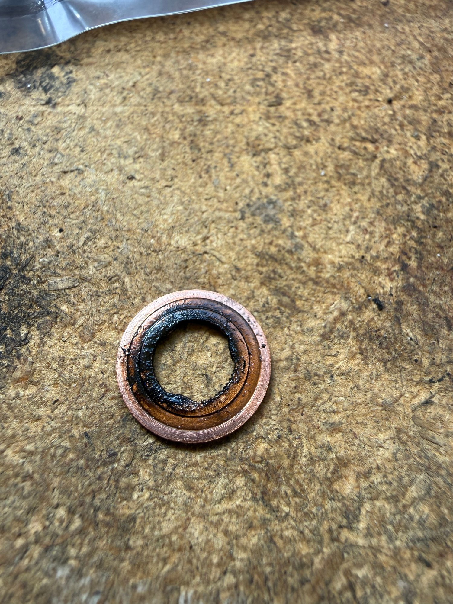

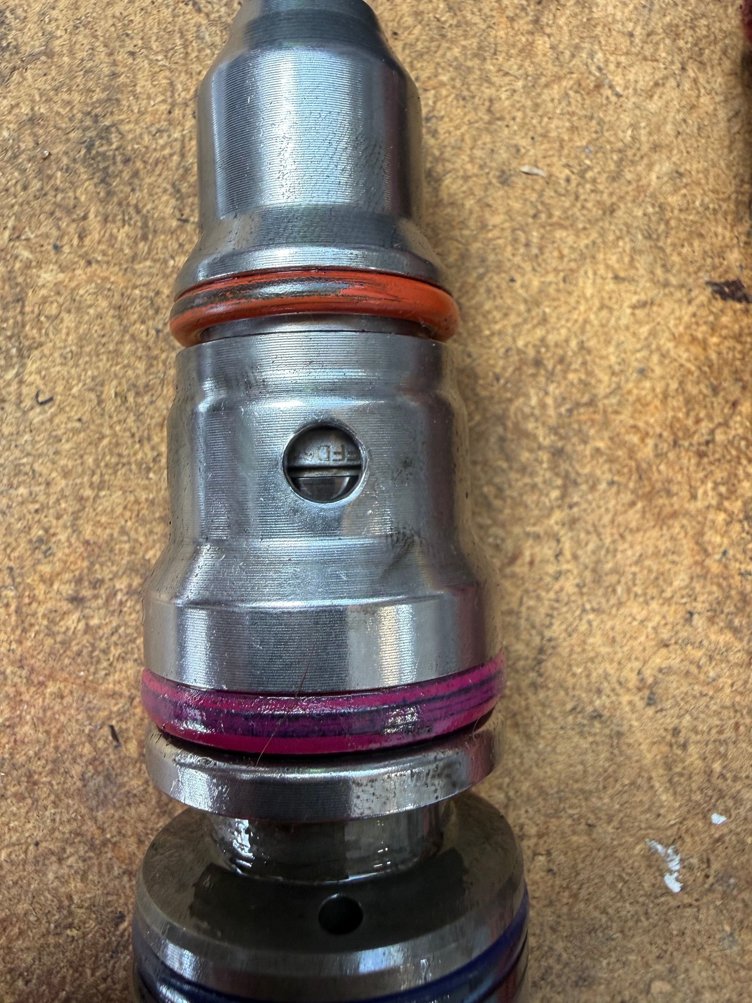

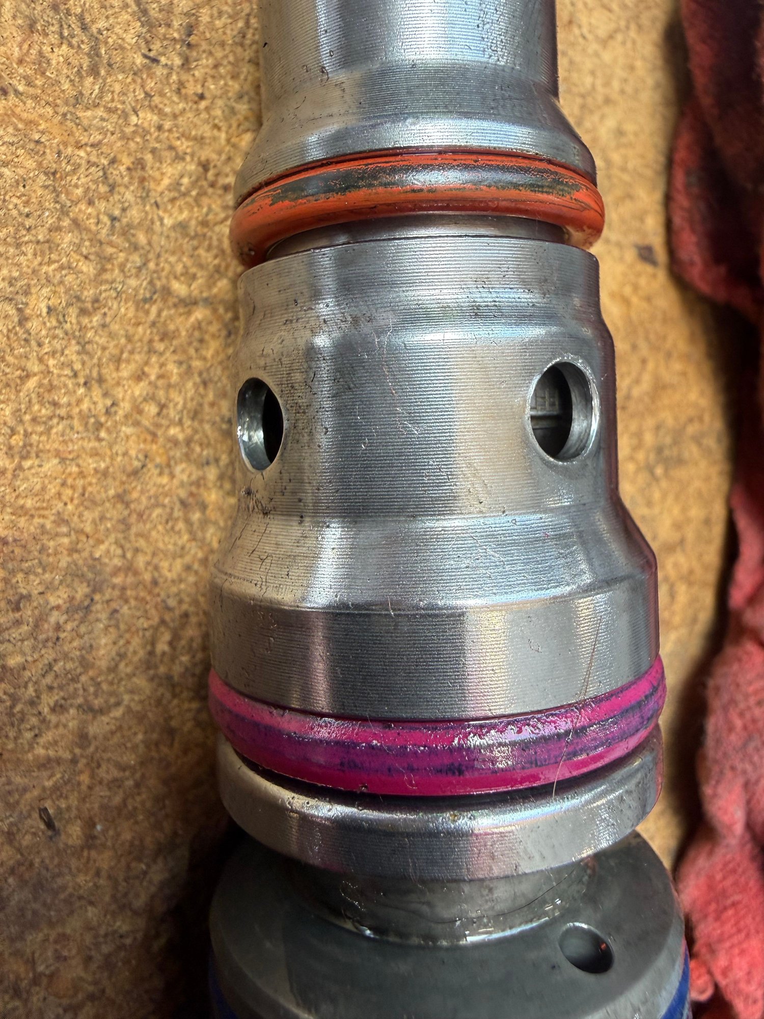

[img alt="What's the verdict?
Looks to be with about 1 hour of total run time it was leaking past the crush washer.
Anybody disagree? Am i on the right track?"]https://cimg5.ibsrv.net/gimg/www.ford-trucks.com-vbulletin/1500x2000/img_9146_6bff99f74a1ae3a7a9b37673b691dc4c9a08606d. jpeg[/img]
What's the verdict? Looks to be with about 1 hour of total run time it was leaking past the crush washer. Anybody disagree? Am i on the right track?
Looks like compression gases past the seal to me.
This is the injector that was the lowest compression with oil residue on the glow plug. I thought the injector might not have been sealing. I pulled it and resealed it. Seems a tad better. I think I have several like this. Still hard start, missing and smoking. Also, has oil leaking out of the exhaust. So I'm thinking either piston rings ( I am doubting it) or the injector seals are bad on several injectors. Had a serious back fire when I used starting fluid after changing the original injectors. My stupid self was working on it while I was sick and didn't think to disconnect the glow plug circuit. So, now trying to keep busy and this is helping.... I guess.

This is the crush washer.
Old Apr 21, 2026 | 03:40 PM
knottyrope's Avatar
knottyrope
Joined: Apr 2016
Posts: 7,222
Likes: 1,343
From: Bahstun
injector not tight enough and made the orings wear is my guess
What did you torgue it too?
Old Apr 23, 2026 | 11:46 AM
Oldman^'s Avatar
Oldman^
Joined: Apr 2018
Posts: 36
10ft#. Think he backfire might have had something to do with it.

Old Apr 23, 2026 | 05:18 PM
Oldman^'s Avatar
Oldman^
Joined: Apr 2018
Posts: 36
It is a very old torque wrench.
So this time I'm running it to just over 10ftlbs.
It is massively tighter. About 2-3 full turns tighter.
7 - definitely had a bad seal.
I'm going through them all and putting new seals on them.
Passenger side is done.
Hopefully in next few days i can do the drivers.
Pull the gp, spit out the oil, do a compression test since I'm there. And check to see what is what.
