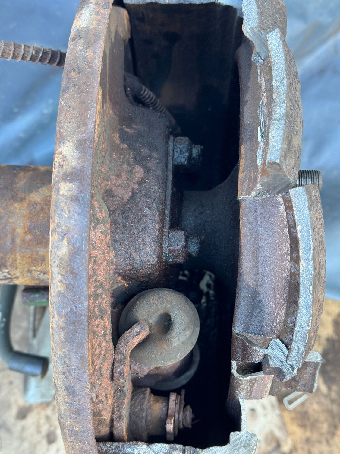

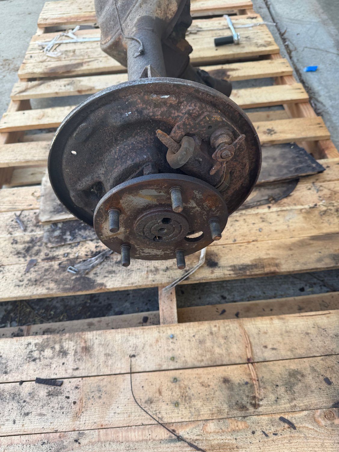

I know the brake components aren’t holding anything, axle rotates freely. Brake pads were rusted to drums when I started. I think I may need to get a large drum puller, I don’t have anything big enough. Once I got everything I could off, I soaked fasteners and surface between axle and drum with PB Blaster penetrating oil.

Wow, never seen one stuck that bad! Can you reach thru your opening with a wrench and remove axle retaining nuts and remove drum/ axle together? Then easier to separate on bench?

I’m contemplating drilling through drum at axle flange hole, then I’d have easier access to the nuts. Thinking about it, I also have ratcheting wrenches, if one fits that could be easier.

Adjusters were rusted and wouldn’t move, through adjustment hole, no way to back brake pads off. Once I cut drum where adjusters were located I saw the rust and cut the adjusters in half. Drum still wouldn’t move. Ended up wedging an air chisel between the brake pads and drum to get everything loose.
Heat may help now, also penetrating oil over night, I don’t have a flame wrench currently.

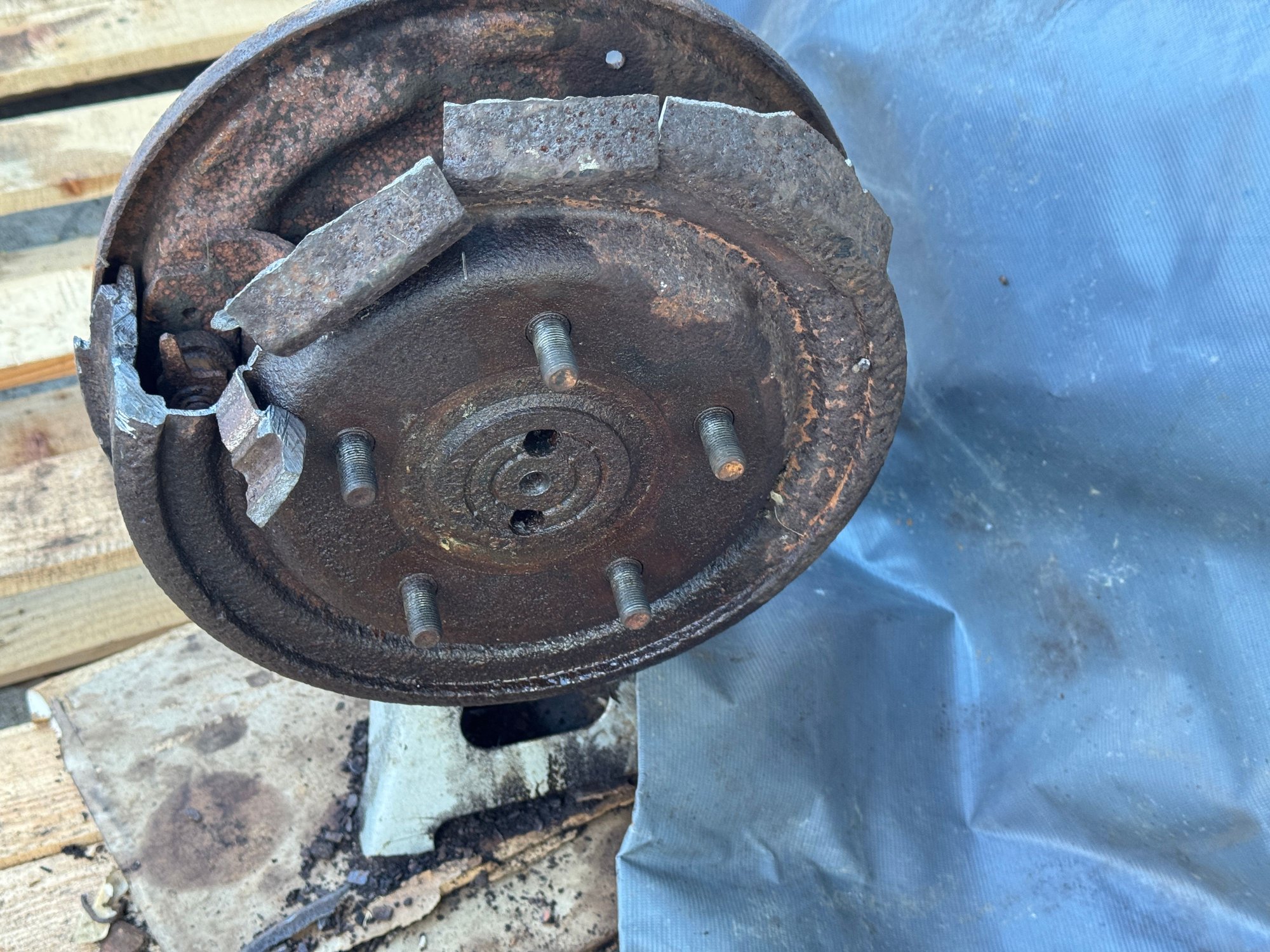

I win
They were definitely stubborn, you could see the drums moving around the studs, however the center wasn’t moving. Once the drum started to flex I was tapping with a hammer didn’t help. Kept pulling until the drum finally popped, sounded like a 22 round.

None that I saw, I did see some rust. I could also see where the penetrating oil was creeping between surfaces.

These drums stick to the axle like they were welded. The way to get them off without breaking the drum is take a puller like shown above and put some pressure on it then heat around the axle and it will pop right off.
