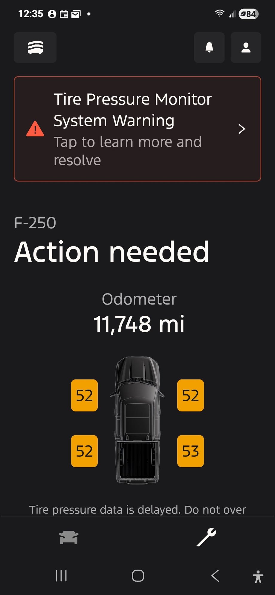

I have a 2019 f250 and a 2025 F150. I keep getting tire pressure warning but it doesn't say which vehicle and when I check none of them are low.

I would think to trigger that warning, you'd also need to trigger the warning light on the dash of the vehicle. Have you been driving both regularly? Sometimes you get a warning when the TPMS battery runs out as well, so the actual pressure might be fine but the sensor could be dead.

This is a Ford Pass message? At the top of the screen, mine is the top left corner, you should have the option to choose which vehicle you're working with.

The alert comes up on messages top right corner no matter which vehicle you are looking at

So you've actually selected each of the vehicles, scrolled to the bottom of the screen and clicked on the symbol that looks like an open end wrench...on the right, bottom for me...and there's no alert showing?

correct

Maybe the app needs to be uninstalled/reinstalled and logged back into. If you log into your Ford account on a pc, do the alerst show?

I reinstalled the app last time and still get alerts. If I log in online no alerts.
I wonder if one of the batteries is weak on the 2019 tpm sensors.

That could well be. I just replaced the tpms sensors in my 2019 wheels so that my new truck would see them. The tire shot wanted $60 ea to do them. I bought pre-programmed sensors on Amazon for less than $90/all 4. Took me about 20 minutes each to swap them once I got thr bead breaking down pat. A week later my neighbor told me that he had a tire machine...
