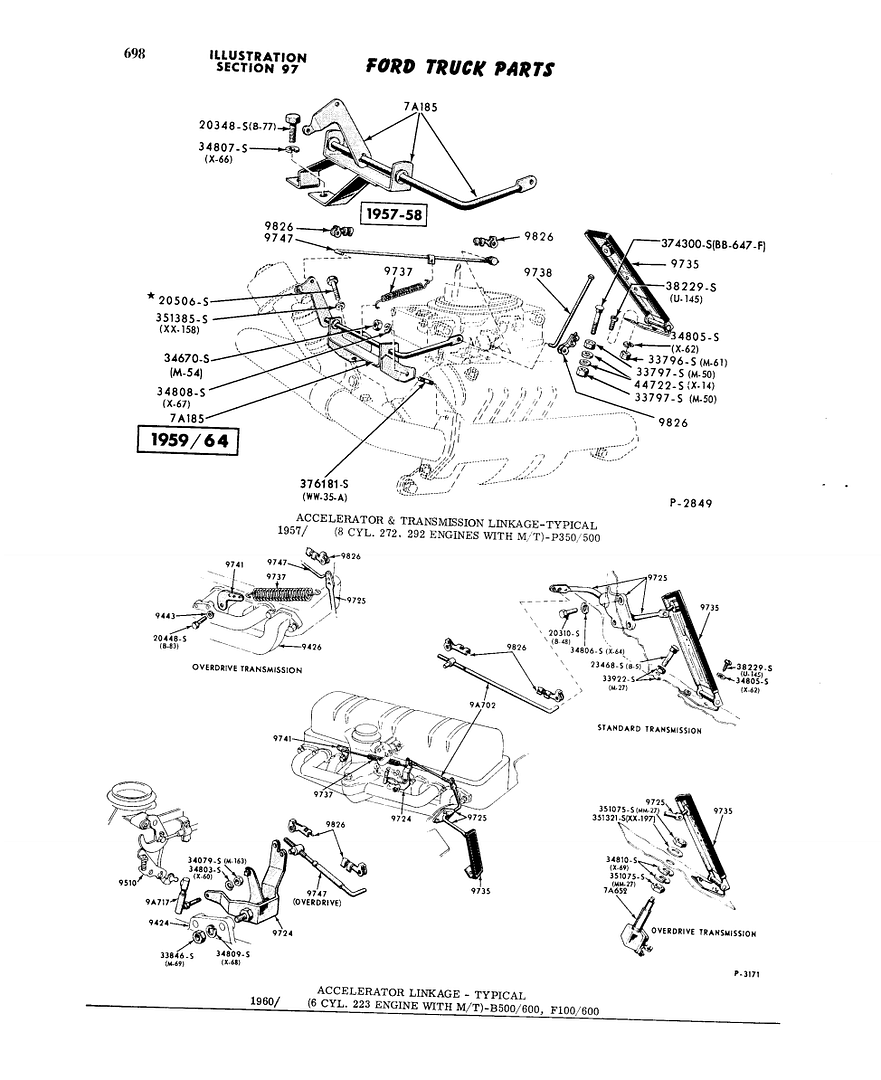

I recently aquire this one owner all original 1963 F100 with a 223 and 3 on the tree. The guy that had it before me had tried to get it running with an Amazon carb before he passed and his grandson sold it. I plan on rebuilding the original carb that came with it but the one on it has it running great. It is a 1904-style carb and I believe I am missing a piece or two. Can anyone send pics of their linkages or the part numbers for what's missing? Thanks in advance

I can offer a drawing from the Illustration master parts catalog covering 1957-1963. I believe it's the lower right corner of this one. The drawings only show a base part number like 9A717 that is then used to look up in the Text catalog for the exact applications of each base part number.

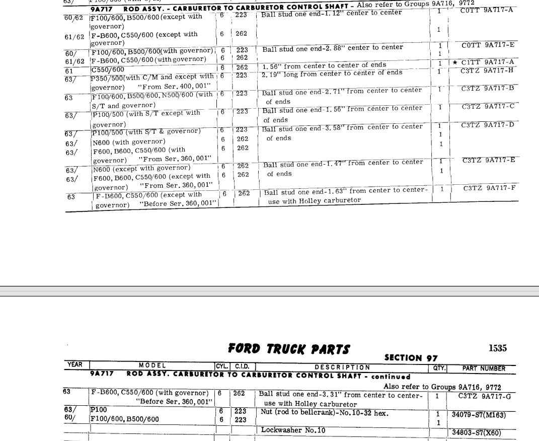

Here's the list of the 9A717 base numbers with the prefix and suffix added giving the complete part numbers by application.
If you give me the base numbers you need, I can look up the full part numbers for you.

Thank you TA455HO, I believe mine should be C3TZ 9A717-B. But it may be C3TZ 9A717-C

The -C is for the Parcel Delivery vans (P-series). The -B seems like it might be correct. Unfortunately, those are obsolete and I'm not seeing any at the usual places (eBay, RearCounter, PartsVoice) so a used part might be the best option if you can find one.
