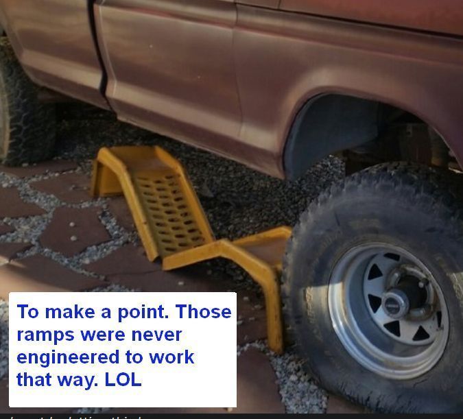

I never trusted them stamped steel ramps to not collapse either, if one was able to get up on them. They look pretty steep too. Two together, hooked together like that, would make a decent wheel chock.

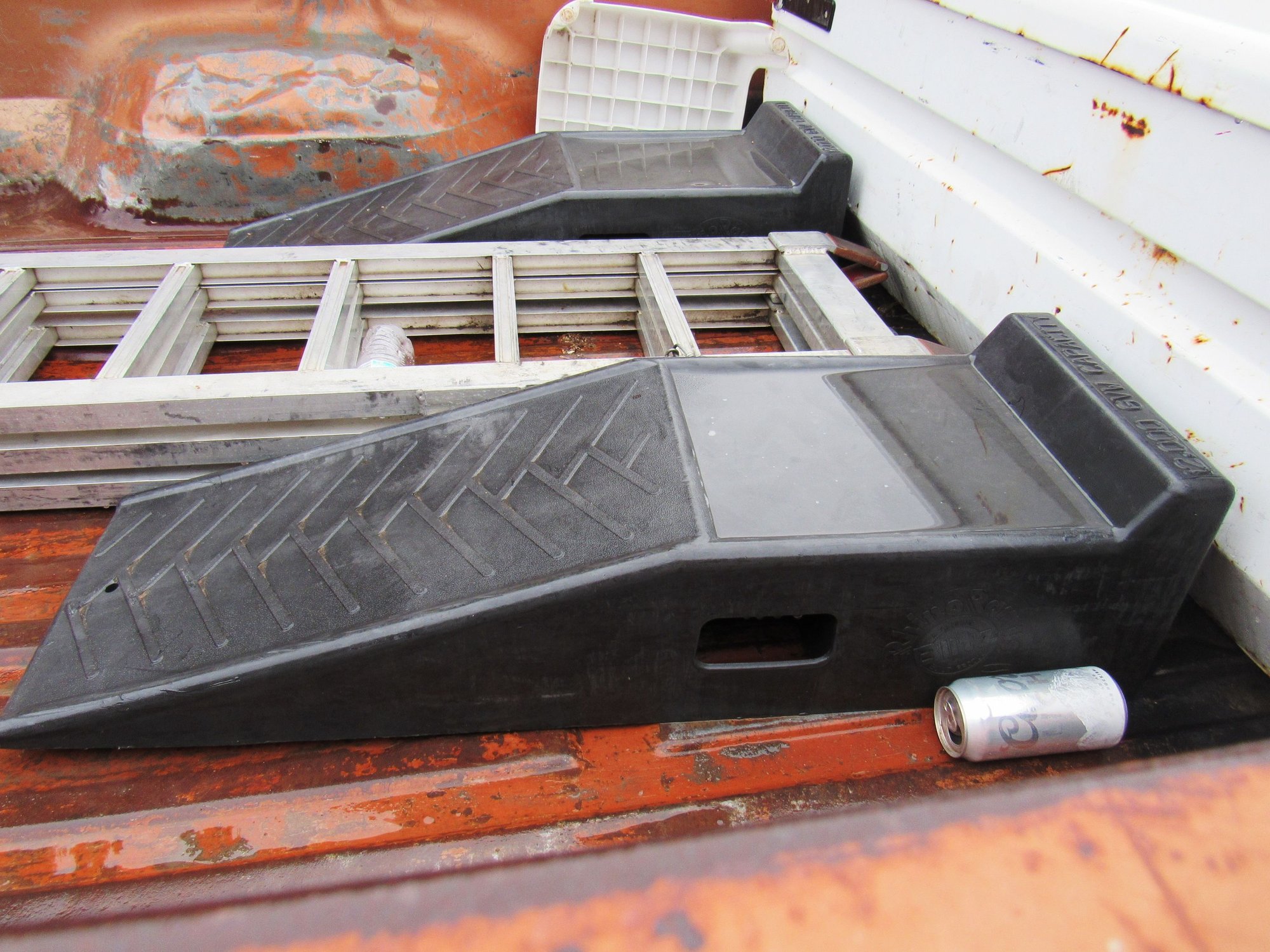

I've had thesef or over 30 years and I have no complaints.
I bought them when I first no longer worked in an auto shop and started doing my oil changes at home.
Never owned a pair of the metal ones and for one reasonor another I just never cared for them.
I also use them so the nose of my ATV clears the toolbox so I can shut the tailgate.
My front axle is 3200 lbs.

Looks like them .... except mine hang on a pair of big nails up on a wall when not in use.

Mine go underneith my camping trailer when not in use.

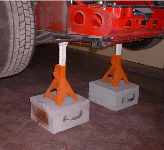

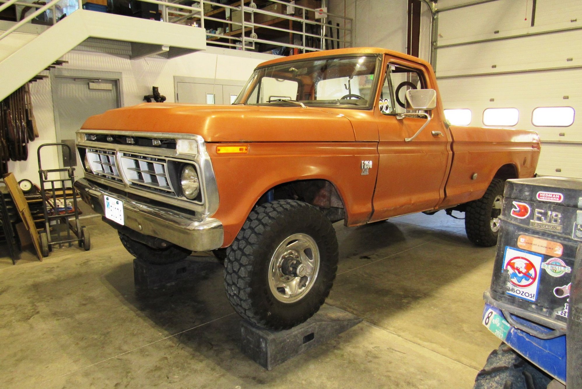

I have seen a guy use 4 of the metal ones and see saw (drive) his truck back and forth (up and down the ramps), moving the ramps closer to each other each time. So eventually the complete truck was ON TOP OF ALL FOUR RAMPS. What do you trhink of this set up?
Not for me.
Looks as solid as if were just the two jack stands. Those blocks are might near solid and are plenty stout & stable.
