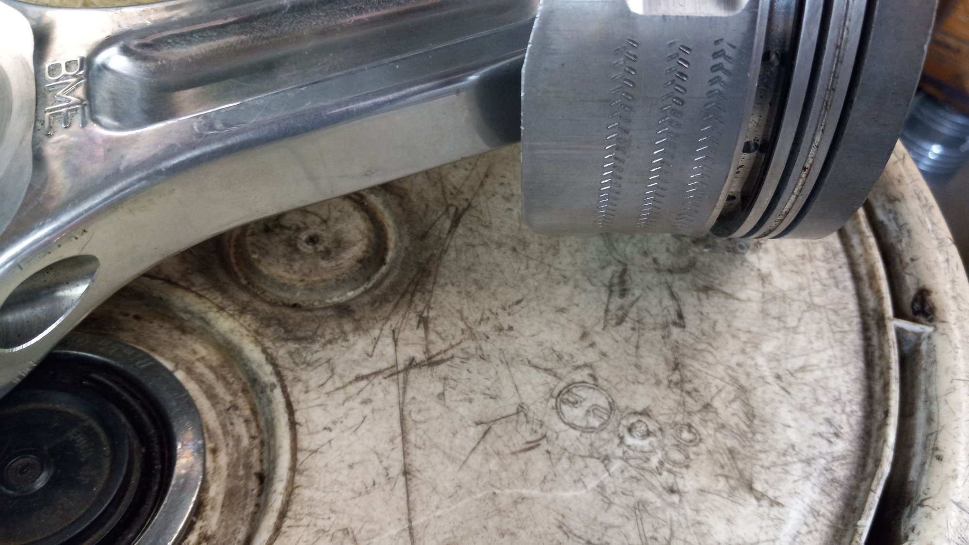

This is a factory piston out of my 410. It was a low mileage engine out of a totalled 1966 Mercury.
It was rebuilt back in 1972 and I have to assume that the rebuilder didn't bore the block because possibly he didn't feel that it neded to be bored.
Instead he had the pistions knurled. I've been told this was a common practice back then and could malke up for around 0.002".
If you want it perfect and want to put a 100,000+ miles on it have it bored, line-bored, deck the block and heads, do everything you can to make it as good as it can be.
I've seen a lot of engines get rebuilt with close to 100k miles on them and never get bored, just a good hone and new rings.
And depending on the bearing wear I've seen them skip machining the crank too.
Rings, bearings, heads, cam and timing gears and hit the road with no oil buring or any other issues.
If I was rebuilding something like a 401HP 390, 352 PI, 289 HP, any of the 3 Boss or any CJ engines, you bet I'd havethe best work done I could find.
A 352, 360, 390... probably not.

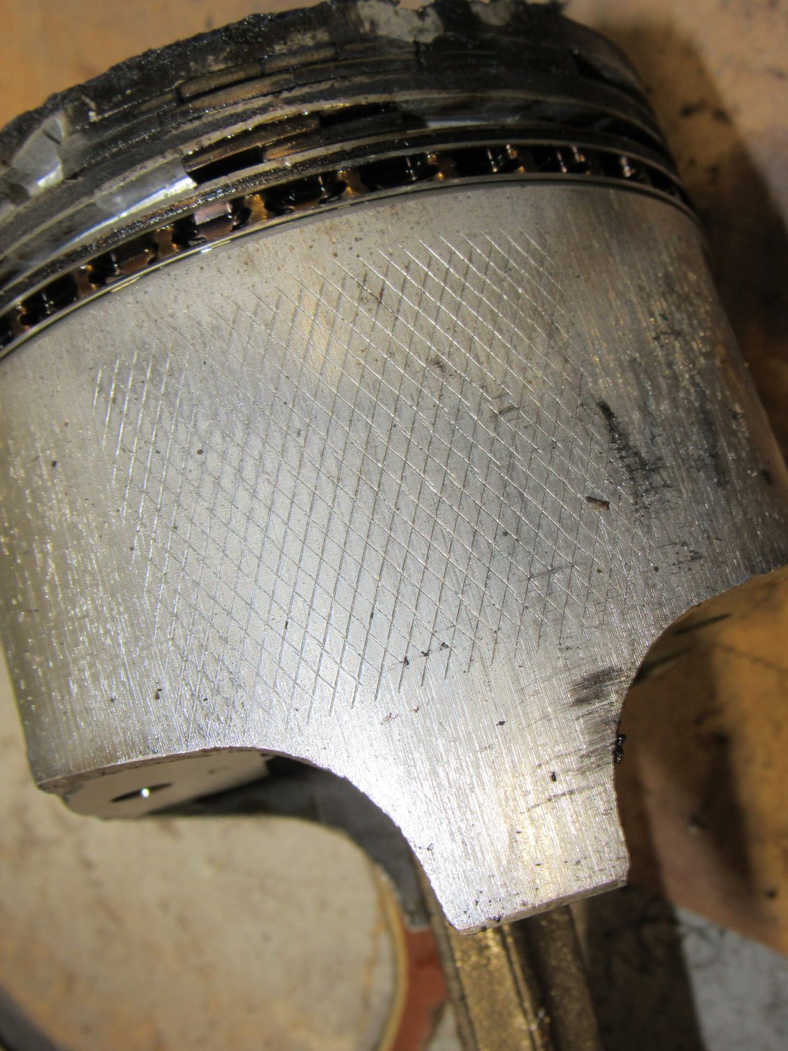

It might be an old idea but it is still done quite a bit today in certain cases. On my monster truck engines the schedule went like this, new pistons, new rods, freshen engine after 1 year. After 2 years change the rods and knurl the piston skirts, 3rd year, freshen, 4th year, change rods and pistons and resize the bores, usually about .005-.007 or so and order new pistons in that bore diameter. It worked fine and it helped the ring life after the piston skirts got knocked back from running. This piston was run for 4 years, rod for 2 years before being cycled out.
