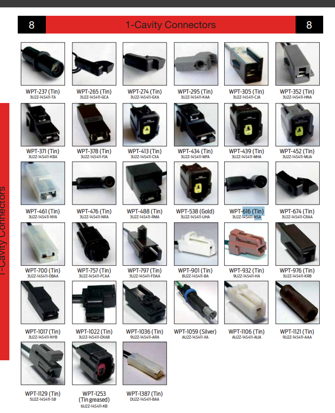

Relay - Starter Motor • Switch - Oil Sending Unit • Switch - Stop Lamp
3U2Z-14S411-NSA
wpt-616
Are out of stock but were current as of 2023

R&R Ford, which ring terminal? I've tried #10 -24 & #10 - 32n neither work. I'm connecting to a T5 Reverse lamp switch....doing a Ford drive train swap into a Mazda RX8. For around 40 bucks I can get the actual two prong connector for the reverse light switch but again just trying other option in effort to save a few dollars.
AuroraGirl thanks for posting the pictures, best I can tell those two connectors WPT476 and WPT616 are the same except one is #8 (approx) and the other #10 (approx) and for some unknown reason the pricing is massively different.
Hitman X I believe some starter solenoids do use the #10 WPT616 connector.

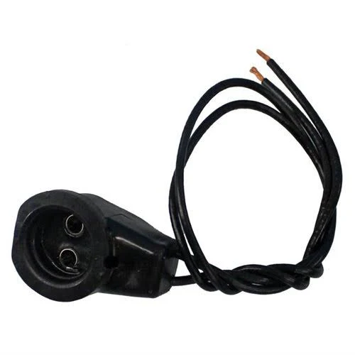

Also looking up, I found 20 dollar "2 post" connector for a T5 with a quick search fopr pigtail. lots of switches are threaded posts like the starter relays, could use nuts/lockwashers and then liquid electrical tape
