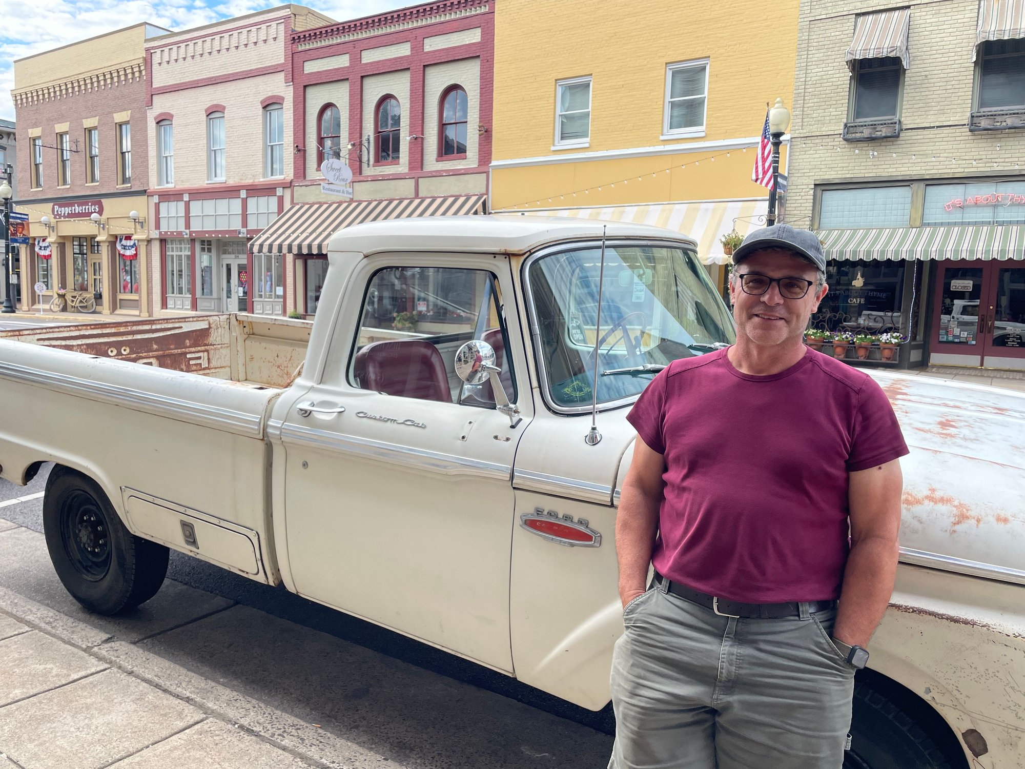

And just to bring things back to all things Ford, and a boy and his truck...
Lucy and I in Culpepper Virginia July 7th 2024 (photo, Andy Lauer)

Matt, a very nice picture of you and Lucy! Awesome truck you have. Looks very straight and no rust! we will need pictures when you get back to it!

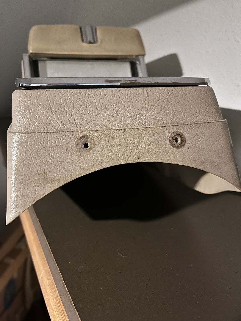

The XLs and Rangers used the same front and rear floor brackets to secure the console. Kinda funny what they did in front where the tunnel is on the cars - the consoles all had the front arch for the tunnel as part of the mold I suspect and on the trucks it leaves quite the open gap where the bracket is behind giving support and they just drilled two holes to fasten it to the front bracket.
Seeing the arch, and assuming that the majority of the arch is, as you wrote, open, it makes me wonder if it would be possible to redesign the mounting bracket, and then make a small drawer that slides out the front, or maybe a slide out cup holder. Using some textured ABS plastic for the front, with a chrome pull, or maybe no pull, just use "tip on", to spring the unit out. I think it could be done to look factory, or at least not be seen, and add practicality.

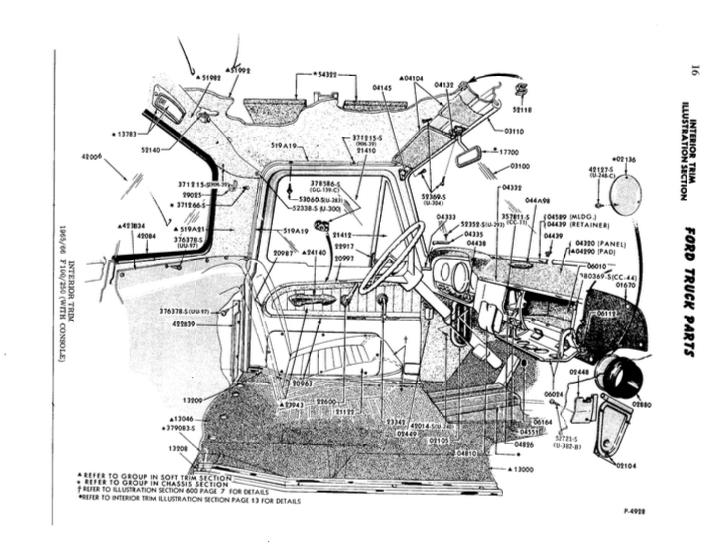

Been trying to learn the MPC system so that I can do some of my own research. Honestly, it is slow going, folks like Chad @TA455HO make it look easy. I am however, having some fun, and came across page 1,645 from the 1965-72 illustrations catalog, and thought I would share. It details Interior trim 1965/66 F100/250 (with Console). While the gauge cluster is all wrong, it still appears to specify interior info for the Ranger optioned trucks. It also looks like the cover for the fuel tank is moulded, something I have read about in some older threads, but not seen.
Page 1,645 '64-'72 Master parts illustration catalog

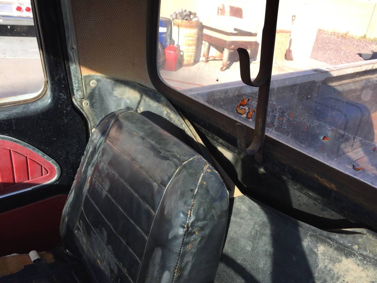

The 1964 XL trucks and the early 1965 Rangers used a vinyl cover. Not really molded just cut to shape and draped over with screws across the top and a couple down the sides. Not too long into it they changed it, so the Rangers got a carpeted gas tank cover. A bit more warm and plush feeling from the carpet.
My 64 XL with the (sagging) vinyl showing.

Ford reused the drawings and sometimes only modified what was needed. The speedo being round would be Standard Cab in F100/250 or 1964 and older Custom Cab. The vent on the far side by the driver's shin is the vertical cable-operated type whereas 1965/66 F100/250 2WD used the hand operated flap which was more triangle shaped. Also, if a drawing says 'Typical' in the description at the bottom of the page take those with a grain of salt. Or maybe a couple of tablespoons of salt. Old Chinese suicide method. Don't drink water or eat for a couple of days and then take 2 tablespoons of salt! Yikes!!!
