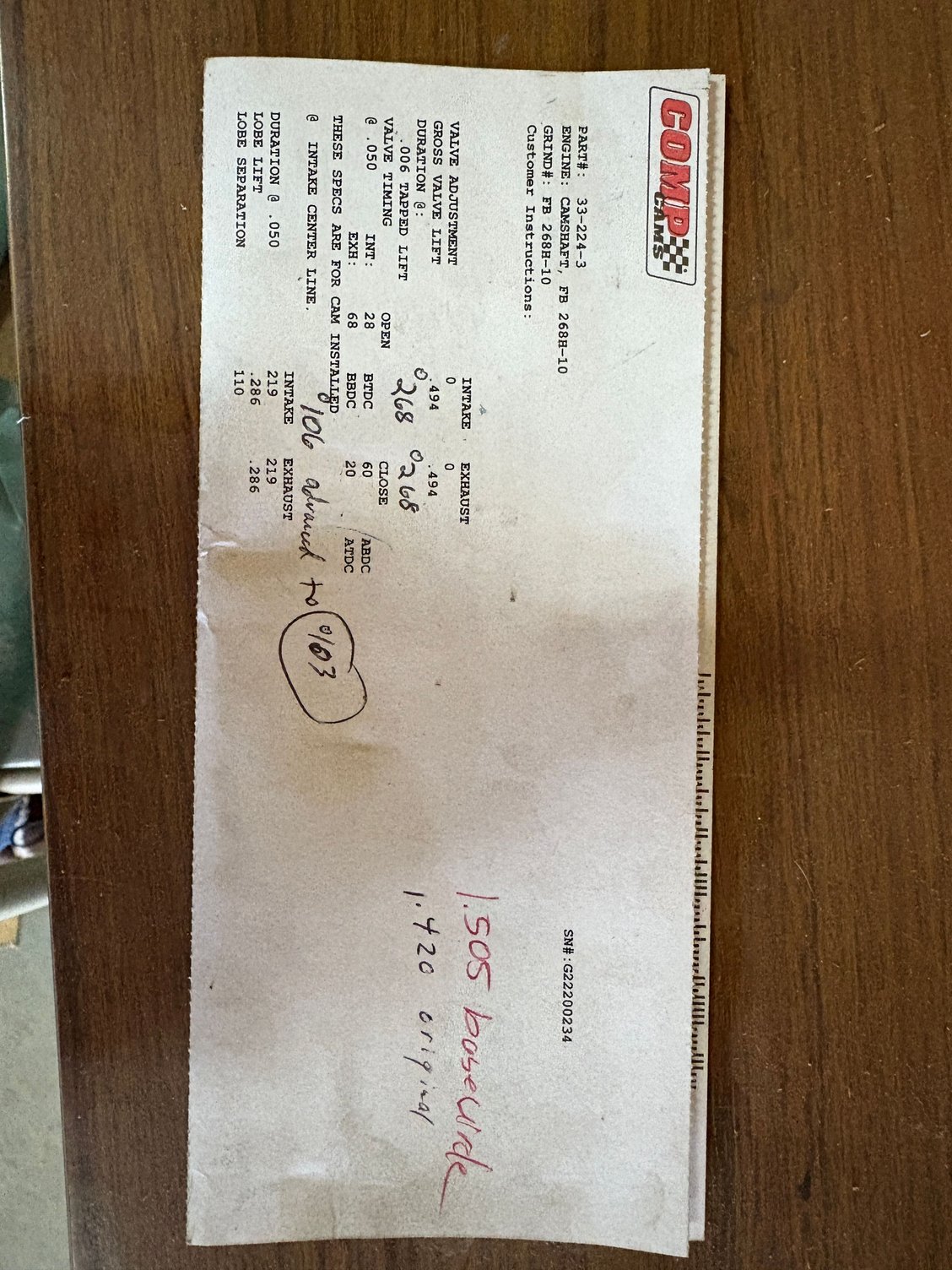

Here is what my engine has and is set at.
Old Apr 13, 2026 | 04:01 PM
DaveMcLain's Avatar
DaveMcLain
Joined: Oct 2020
Posts: 2,676
Likes: 785
A 268H is just too much duration for your application. The engine is overcammed. Being out on 110lsa is not optimum for making mid range torque and being up there at almost 220 @ .050 is about 10 degrees too much duration. They have the cam 7 degrees advanced and while advancing the cam tends to help low end torque by closing the intake valve earlier, all events are moved so that means that you're also dumping the exhaust early and this hurts torque and makes the EGT higher.

What setup would you suggest for my application?
I would like this thing to be as powerful as it could be with good drivability and ability to push the truck in overdrive.

I think that it would be best with a cam that's about 205 at .050 on a 108 lobe separation. Then put it in the engine with some advance on a 104 intake centerline. Your engine has got some compression but you're also at a pretty high altitude so that mean it really needs to be cammed using a strategy for low compression. This should give it a lot more low end torque when compared to a stock cam or what you have right now. It will have a somewhat noticeable idle but not too bad.

Would it be worth retiming the current cam and setting it back to 4 degrees to see how it would like that?

There is always a centerline that's optimum for a given cam in an application. Usually advancing will help low end power and idle vacuum but only to a point. Going farther tends to go in the opposite direction. You could try moving it back 4 degrees as a test. It won't hurt anything and you've already got the cam, its broken in and installed in the engine.
